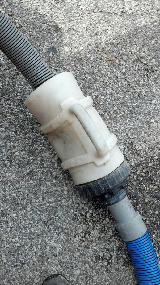

I don't know how many times I told Mytee that their filters were collapsing. I was told it was only me (I hear that a lot) and no one else was having issues.
That is not my filter. I chucked my third Mytee in the trash out of frustration and now use the best filter in the world.

Looks like you drove over that mighty filter, did you?
117,224
Not my filter.
They cave in due to suction and the warm water.Wrong type of plastic and stubbornness on behalf of the owner to listen to sound advice.

My mytee filter collapses on every job...I was told to come by their factory and they will replace it.
I run high heat high flow..once you're done, its almost impossible to unscrew the top to clean out..that's how deformed it gets..more than what is pictured here.

I wouldn't mind helping out...if asked. I would have been able to show this filter doesn't stand up to warm water coming BACK from already been traveled thru the pressure line and carpet and vac hose. Btw the blower that is being used with that filer is a roots 45.
117,224
I think it would cave in if used with their ETM honestly..
Just the wrong sort of plastic for this use.

I haven't sold a ton of the lint hogs but I also haven't seen any come back because of it caving in.
117,224
Fifty feet away from the Judson John.
A filter should be able to withstand being five inches away from any tm imo.

I doubt Mikey is making this up, so assuming it really happened the way he and that mystery cleaner says it did, then that's two too many times. Regardless of how many times a distributor hears of the problem.
I get a bum rap OFTEN for reporting problems with chemicals and equipment, and Mikey gets it twice more often than I do. While Mikey has to be under some pressure not to insult an advertiser here, he seems to be somewhat resistant to that pressure ... to a large degree. So, I would like to go on record as saying I APPRECIATE Mikey's honesty in this.
We need to hear of these problems every time they happen, and no matter WHO the mfg. or dist. is.

John, my filter came from you but when this issue came up before either Nathan or mytee John told me right away to just come over to their place. And yes I told them I got it from you.
As far as it being too close to the machine...mine is about 8 feet away from the top of the waste tank. In my opinion, if it was closer to the wand, it would collapse even quicker since the water would be even warmer there.

obviously by looking at the picture he's not making it up I'm just saying we haven't seen it yet

Just to be fair about pre-testing here . . .
there have also been heat related issues in the both the Interlink & Mytee screen filters that go inside the outer housings.
Both companies have replaced the screen inner filters without questioning.

No, not a Vortex
Steamway Powermatic with relief valve set at 14hg
How far away from the blower is it?
haven't a clue what that would matter , do you?
but i'd estimate it's 5 to 6 ft
truth is, it's the first time i noticed it really (but I'm not on the truck a whole lot anymore)
Shane or Cody have never mentioned it.
TM and crew has been running harder than "normal" the last week or so is the only that's different.
Pretty much continuous flow with wand or upl tools on the floor or fabric for hours upon hours (6 to 8 continuous TM hours daily)
Which isn't "normal" for us, cause we rarely do any jobs where the TM runs more than a few hours continuous
i walked out today after a couple hours run time to turn on the pump-out and saw the filter :eekk:
looked at the vac gauge and it was pulling around 12hg
an'ats the truth, the whole truth and nothing but the truth
so where's the devastator filter guy??
I need a new filter , cause I figure this filter will be toast now
(like when a vac hose kinks the first time..it'll kink all-de-time in that spot til you cut it off)
How come you didn't call me? I have no way of knowing if you don't call me.

I am not by any stretch saying it aint true. Just I have sold a ton of these things and until Zee mentioning here no one I sold them to (including zee) has called me and told me this was happening. If it is a random thing that's one thing but if it was a serious issue I would expect to here about it like I did with the screen filters Larry is talking about.

The filter caving in was talked about before. I just noticed I got the filter on that week or the week before that thread was up and even said there is no way it would cave or collapse...I guess about two three months of use when it started giving up and caving in...Which reading now how I thought "there is no way it would cave in"- sounds pretty funny..
But one thing for sure- this has been a topic before and came up multiple times as it is here.. http://mikeysboard.com/forum/showth...ne-vacuum-debri-filter&highlight=mytee+filter this thread was over two years ago.
