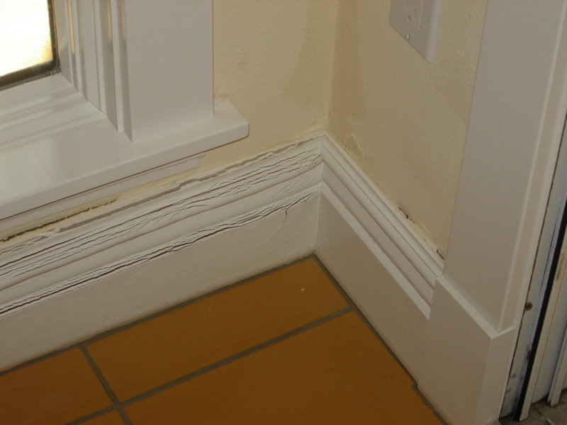

McKinley that's the worst I've seen. I usually see them split at the joints but man, thats bad!

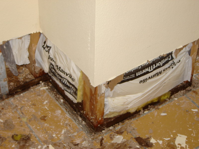

Yeah, it was lil wet...
Needless to say the wall had to be demoed to dry the SOLE plate and wall Studs...

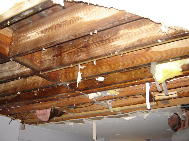

We also had to demo the ceiling below to gain access to the floor joist and the SILL plate upon the concrete foundation wall...

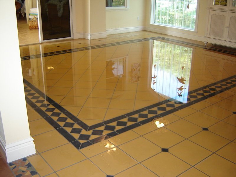

It was a challenge, the tile and sub floor took awhile to dry...once everything was opened, dried right out... we had like 50 axails and 10 lgrs on this loss for 10 days.
