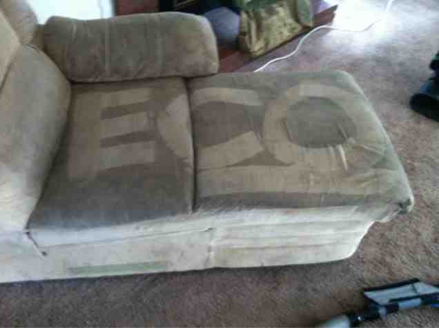

I used one for a while(I need to put it back on the truck), it was taken out when I cleaned out my van. You can get this one a Walmart:
View attachment 3351 I need some more micro fiber pads for it but it work well.. I think it was like $20-$30.
