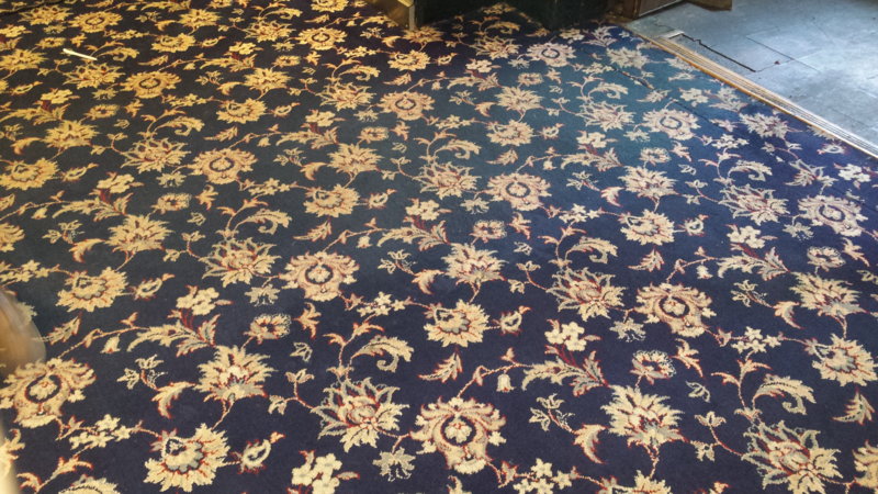

I really really impressed lately when prescrubbing areas with some newly acquired combo microfiber/scrub strip bonnets.
They really chew through dark traffic lanes, and based on the immediate visable results, the notion is that they are picking up a good amount of soil.
Yet I am very surprised every time I finish a job, and proceed to rinse them out.
Every time I expect to see the pads give up what they got, and turn the water black, I am somewhat disappointed by what seems to be rinsing out, as it appears to be minimal, barely browning the rinse water. Nothing compared to rinsing out even a moderately soiled cotton pad in my experience.
Either the microfiber material being used has a great ability to not only trap soil, but also to RETAIN it….. or…… they are not actually removing as much as they appear to.
