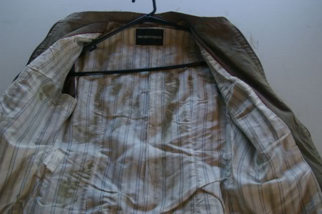

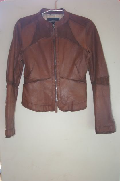

Richard, here's a AU$3,500.00 Armani that we resurrected.
This Lady owned a group of dental surgeries and simply said, "If you can't save it, chuck it in the bin"
She has since referred over 20 customers to us, all good paying ones for Oscar Ash.:winky:
Sometime they pay by check made out to my accountant, C.Ash. :winky:
We do get a lot of mo(u)ldy leather clothing as well as furniture.
