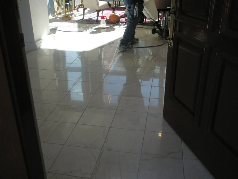

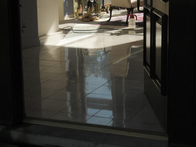

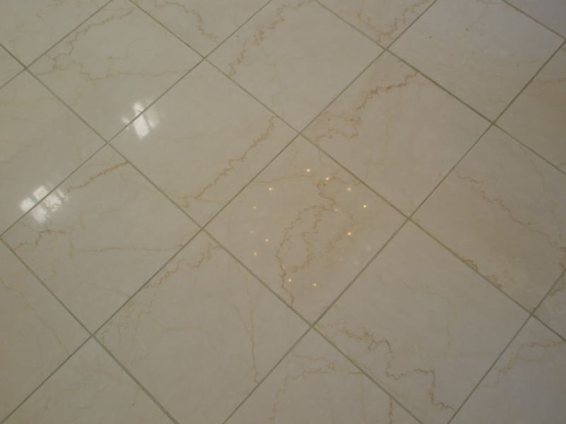

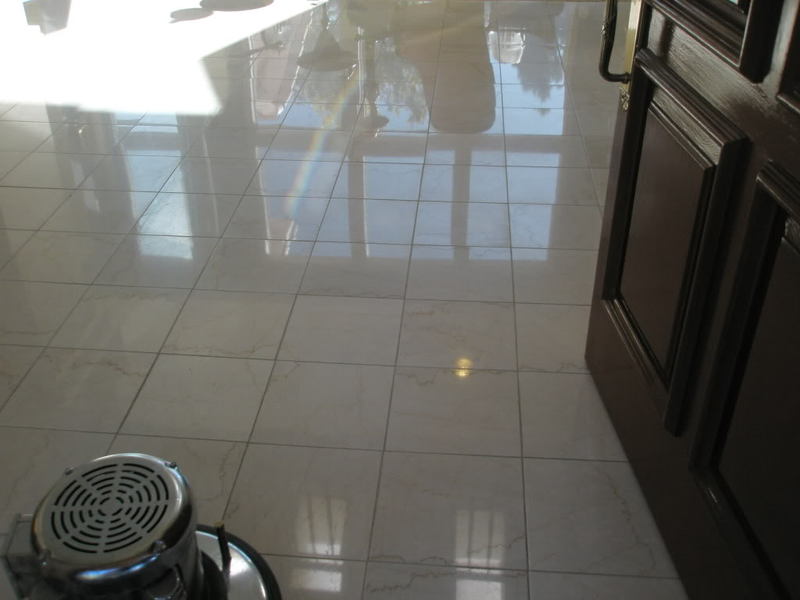

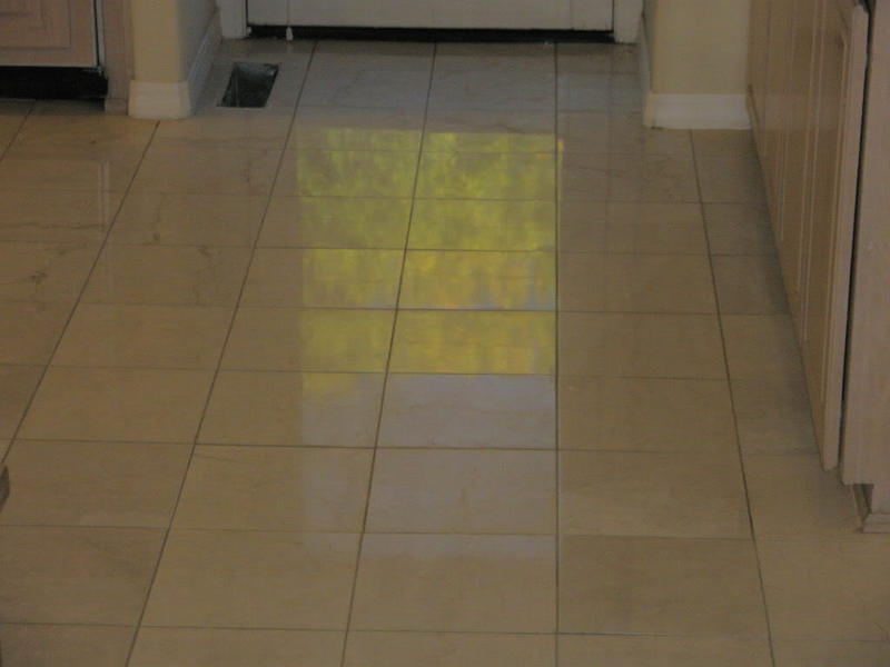

/22 year old marble floor
before
skirt
during
after

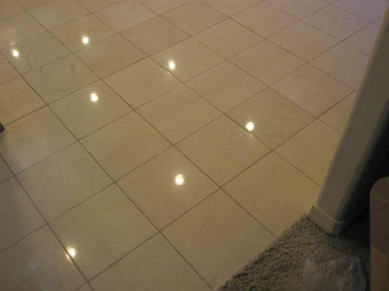

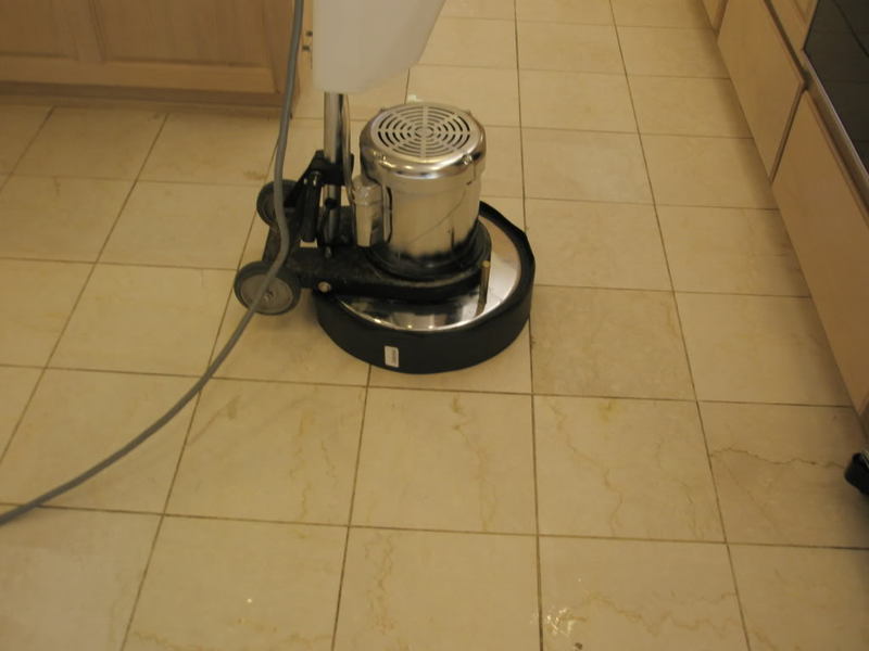

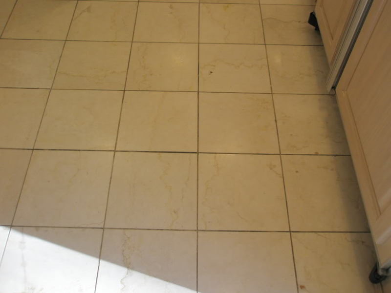

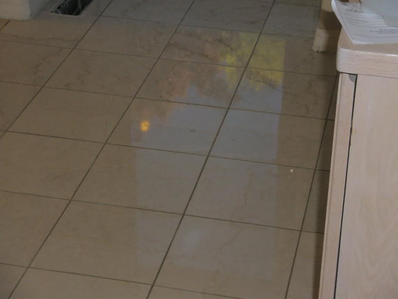

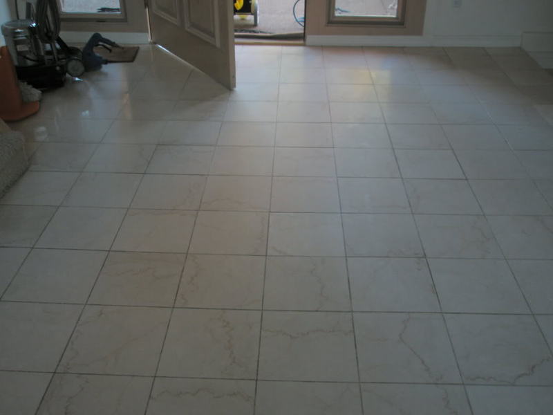

half done i will put up more tomorrow
it is a lot of work but I love it.

Looking a lot better!
What grit did you start with?
What grit are you on now?
R
Ron Lippold
Re: monkey pads it gets better
went from 800-11,000 we have about 1000 more sqft tomorrow

Looks real good Ron.

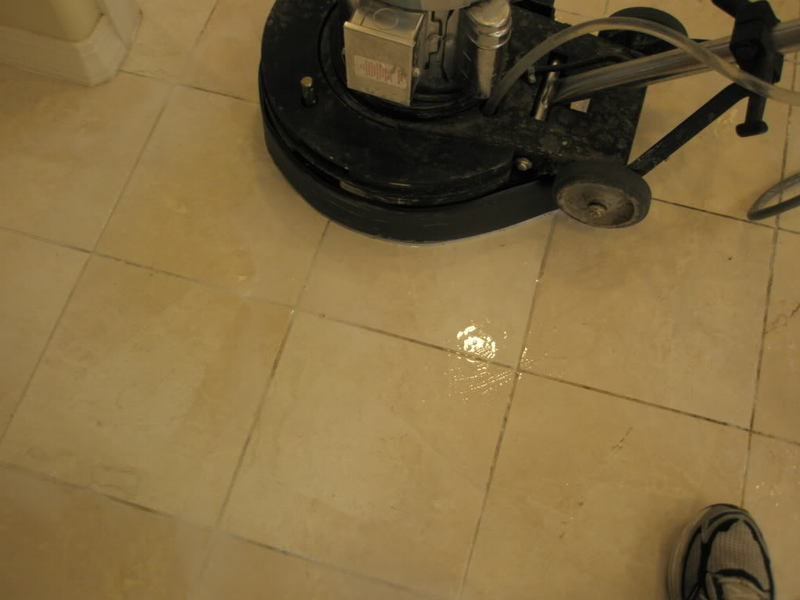

Ron in that picture it appears as there was a good bit of lippage. Was there? Have you done a job with MPs that had a lot of lippage?
R
Ron Lippold
stone was smooth but there was a good grout line I think its a little tough on the pads but its only money.

Are you going to do something with that grout?
Did you have to do all the edges by hand?
I do like that fact you have so much fun with new things. Thanks for sharing.
R
Ron Lippold
grout was still wet, there was a bunch of wax in the grout lines 98% is gone I love new things

yea water and MONKEY PADS but you do need a little weight I was runnin 50 pounds on the weighted floor machine.I feel broken but the bank account is feeling better, corners are a pain in the ass we used the makita 7in and the counter top pads. someone need to come up with a better driver for the small pads.
This is alot of work, but well worth it so far over 5g out of the box of monkey pads.
