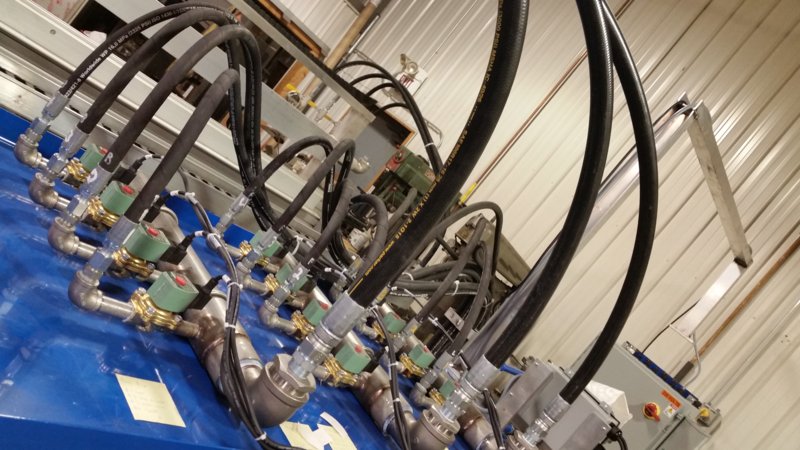

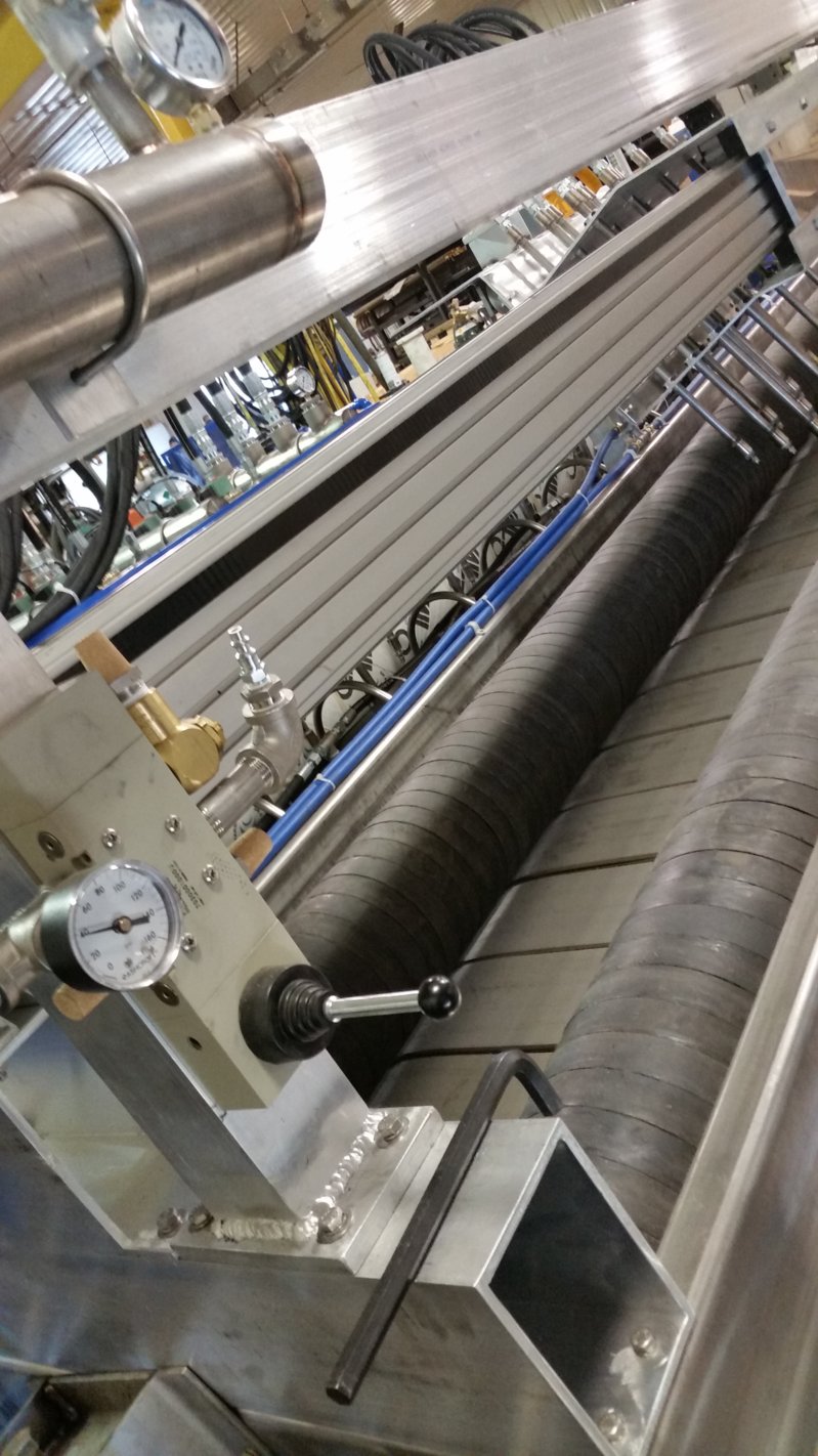

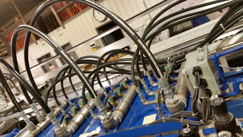

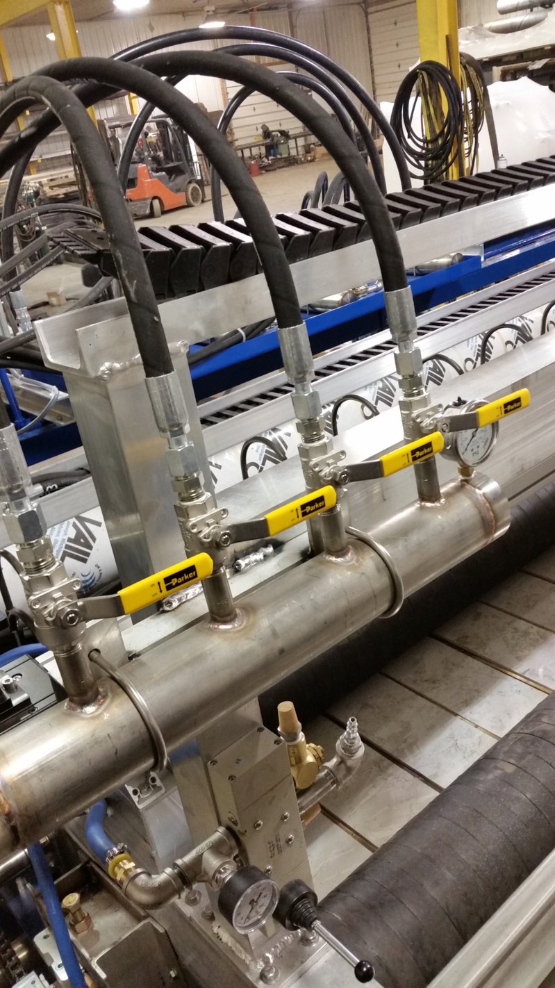

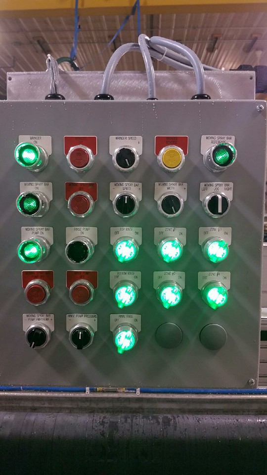

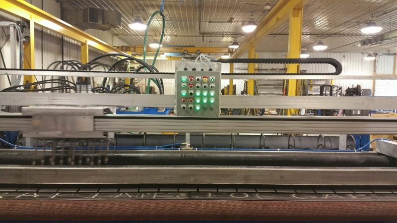

The 2016 version of a movable power spay bar accessorizes a Moore Rug Washing Machine. The objective is to mimic power washing rugs that is traditionally accomplished of a wash floor with human operators. However, much of the mechanics of the travel bed with conveyor belts will stay basically the same. This concept dates back to the 1950's right through to the current year. 4 years ago when Centrum Force bought the Moore Company, we understood the working parts, as such, proved reliable after standing the test of time.

This is a slightly different apparatus compared to what our Centrum Force company installed on Hagopian's Machine. Functionally, it is the same.
