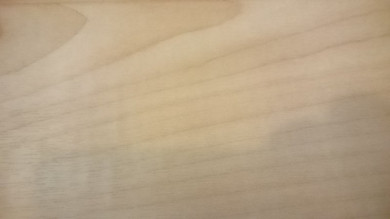

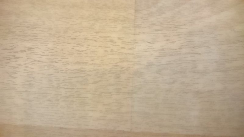

What do you normally do and charge for such vinyl floors?
I did a little test area with some leftover Powermax and ran the 10crb over it. Wiped up the slop with a wet microfiber and called it good.
This will be an absolute money printing business. Quick and easy and the average homeowner doesn't have the ability to scrape out the billions of tiny grooves.

I also just did a job last night on laminate flooring... livingroom dining room kitchen...didn't scrub with crb. Only rand the RVxl pad driver with pads and then wiped it up with microfiber. $200bucks for an hour. good thing they weren't there.
