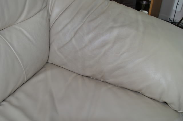

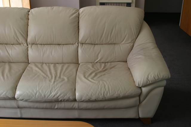

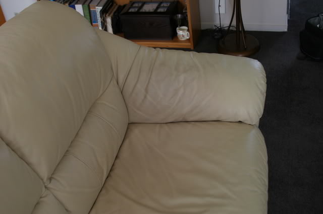

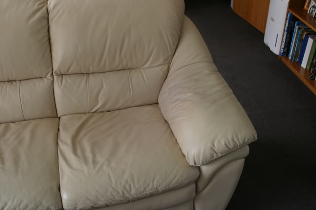

A client called with a the need to 'clean' her MIL's couch a week out fro Christmas because they were visiting from out of town.
Cream finished leather in overall good condition except for some dye transfer. I nornally try to do any leather work but it had to be done when I couldn't get there and my tech went out to 'clean' this suite.
He hasn't come across dye transfer before so it was a new problem to him. He called me very soon into the cleaning with the problem and in the end, I r4e scheduled for when I could get there.

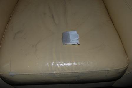

In the mean thime, I spoke with the client and she told me she had some black cushions on it... immediately a light went off in me head as to why Jesse couldn't remove this 'soiling'.
The client wasn't home when I called, so I have no more conclusive data, including no idea what the cushions looked like sorry. I used a dye transfer remover to no effect. The dye seems to be IN the leather now.
Overall picture.
Close up of dye transfer.

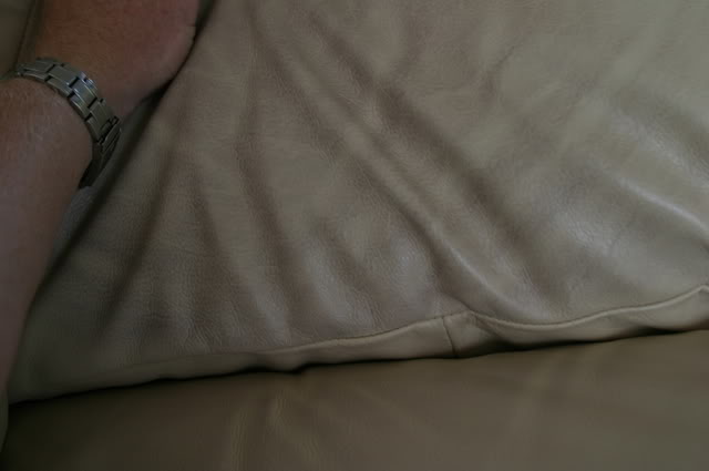

But while there, I noticed another 'problem', in any light, there is a 'green flourescence' type discolouration on the body contact areas od the arms and the fronts of the seat cushions.
Adding this next problem in (which the client hasn't raised with me so maybe unaware of) I'm beginning to wonder if there is a fault with either the leather finishing of else a flow on effect from inappropriate use of products during it's life.
This is the first case of dye transfer taht I haven't been able to correct. I'm wondering if a re colouring is needed but I was honest with her and said I didn't know but would ask some questions of you guys.
Suggestions? Cures?

Some of those light colors do that for some reason. For me it would definitely be a recolor job. Just like you I would've first tried one or two things to lightly abrasive it off. Then if that wasn't removing it, sand, prep, and recolor. I know Roger has a few tricks up his sleeve, but for me it's easier to move right to recoloring. Even though it's technically dye transfer it has now become in the same category as if the color had worn off. In the past I've spent wasted time trying to clean only to have to still recolor.
A
Andya
Dye transfer can be a real problem and as you have rightly said the dye has now travelled into the leather finish and is now a restoration problem rather than a cleaning one. There are cleaners specifically formulated for dye transfer but these are not guaranteed to remove it when it has soaked into the finish.
The greenish tinge may be caused by the cleaning process. The dye will be made up of several colours and the cleaning process may have removed some of the colours but not others (we have seen this on more than one occassion) eg. the blue and green elements may have sunk deeper into the finish and cleaning may have removed the red elements leaving a different colour behind.
The only real recourse now will be to recolour and refinish the leather. Use alcohol cleaner first to see if this will remove any more of the dye and then proceed through the recolouring process.
It is always adviseable to remove as much of the dye transfer as possible before recolouring to prevent any dye coming back through the new pigment.
Hope this helps

My tech cleaned the two seater, so any discolouration is from previous cleaners and not us.
On the dye transfer, I first used a transfer dye remover from Fenice, when that failed, I tried a strong cleaner then as a last resort, SPS - surface preparation solution. This will take off any clear finish and start to remove the pigments. I deliberately did this to see if it was IN the pigment and as I was removing cream pigment, the black colour wasn't moving at all.
I'm not into full colour restoration so will pass on to another company a couple of hours away that does.
Thanks for your help.

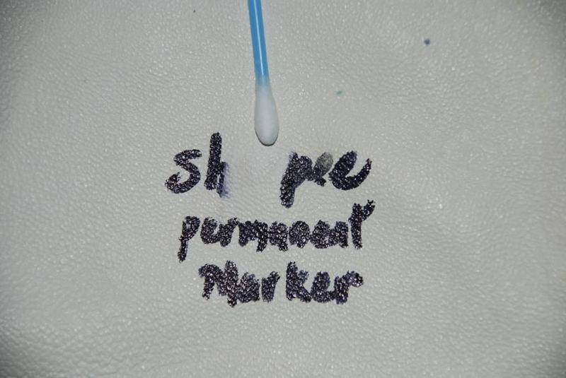

I agree that the last resort is a re-coloring job if all removing attempt fails (depending on severity of dye penetration).
And for re-coloring in this situation a semi-aniline system is preferred.
A pigment system would be too heavy that flatten the grains.

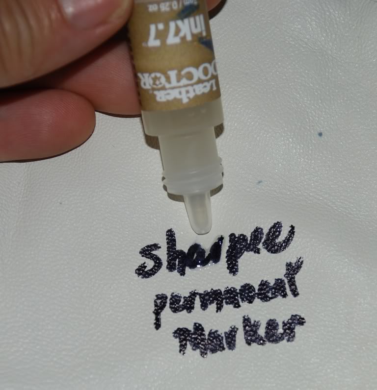

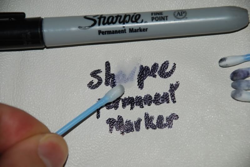

#1 Remove dye from Jean - use d’Ink7.7™ > clean3.8™ > rinse3.0™.
#2 Dwell and agitate.
#3 Extract
#4 Finished.
#5 Permanent Marker removed by either d’Marker10.5™ or d’Ink7.7™.
#6 d’Ink7.7™ in action
#7 Optional bleach10.3™.
# 8 After bleaching
