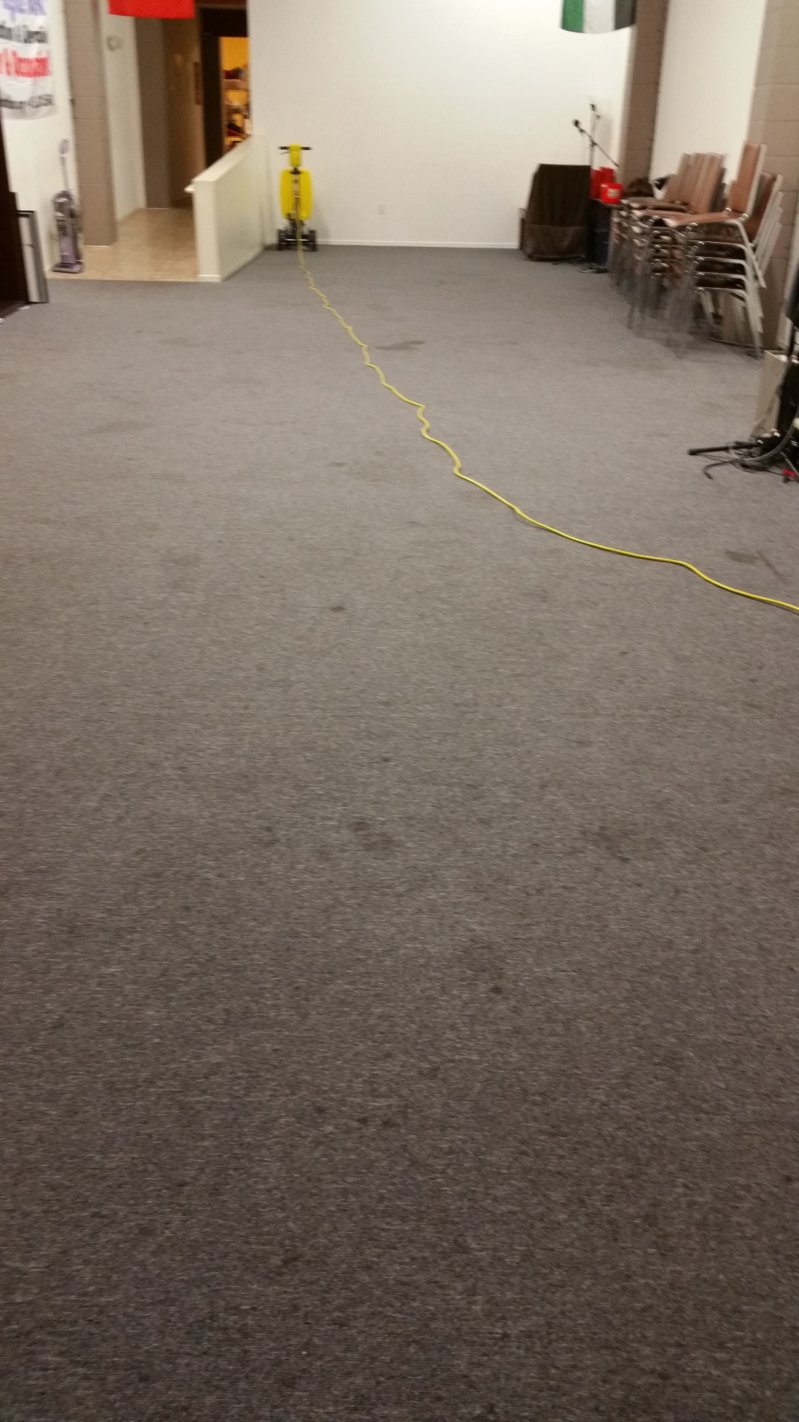

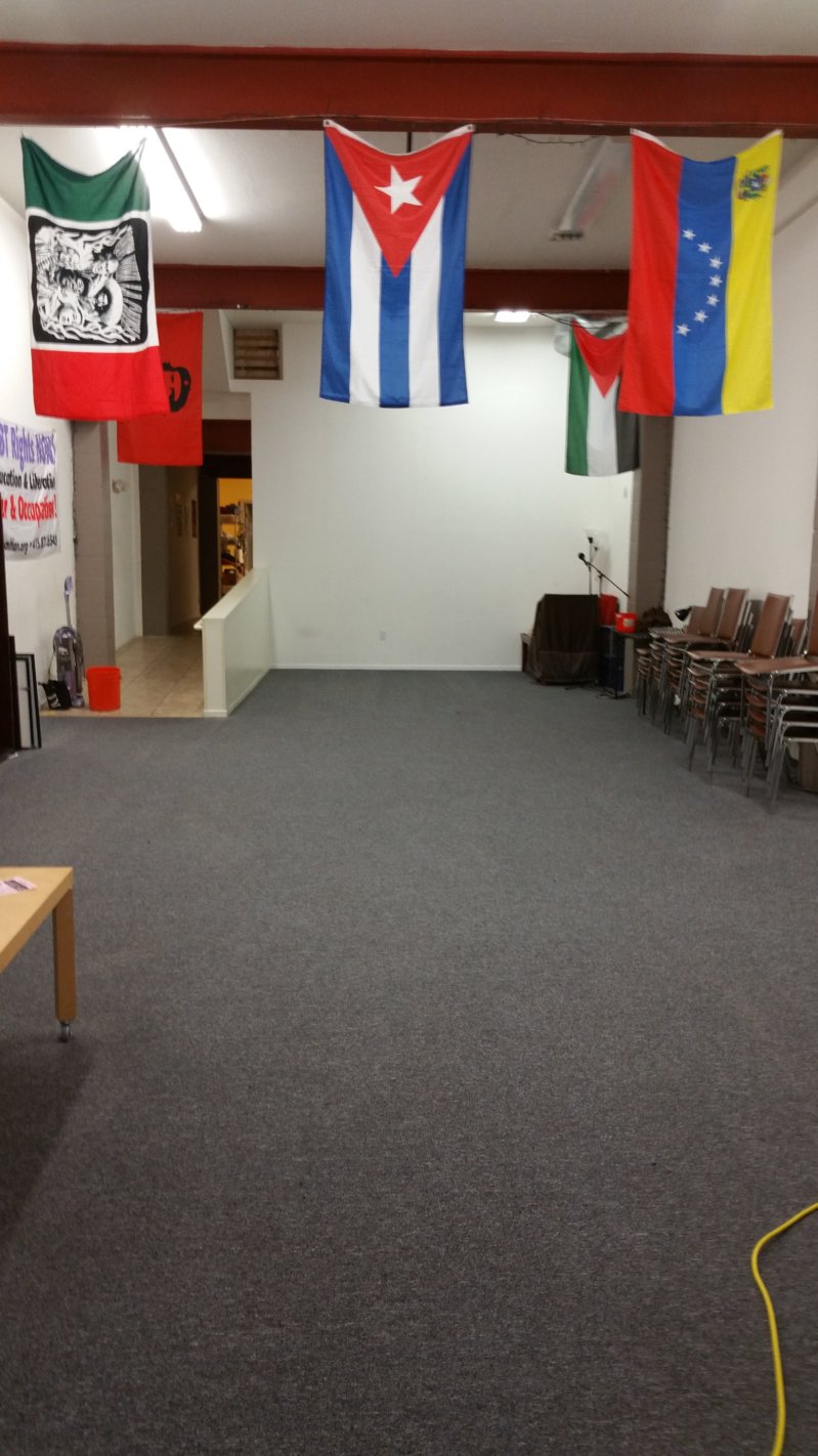

I did my 1st ever encap job.. the customer and I were pleasantly surprised at the results.
It was only about 1000 sq ft- and took about 1 hour so I don't think there was any time saving over HWE-- but Encap was easier on the body.

Good looking results!
What machine did you use?
With practice your speed should increase.

I guess after a certain age you guys don't notice the cord and the machine in the picture...?
I was surprised too.... to see Rick asking that question..
