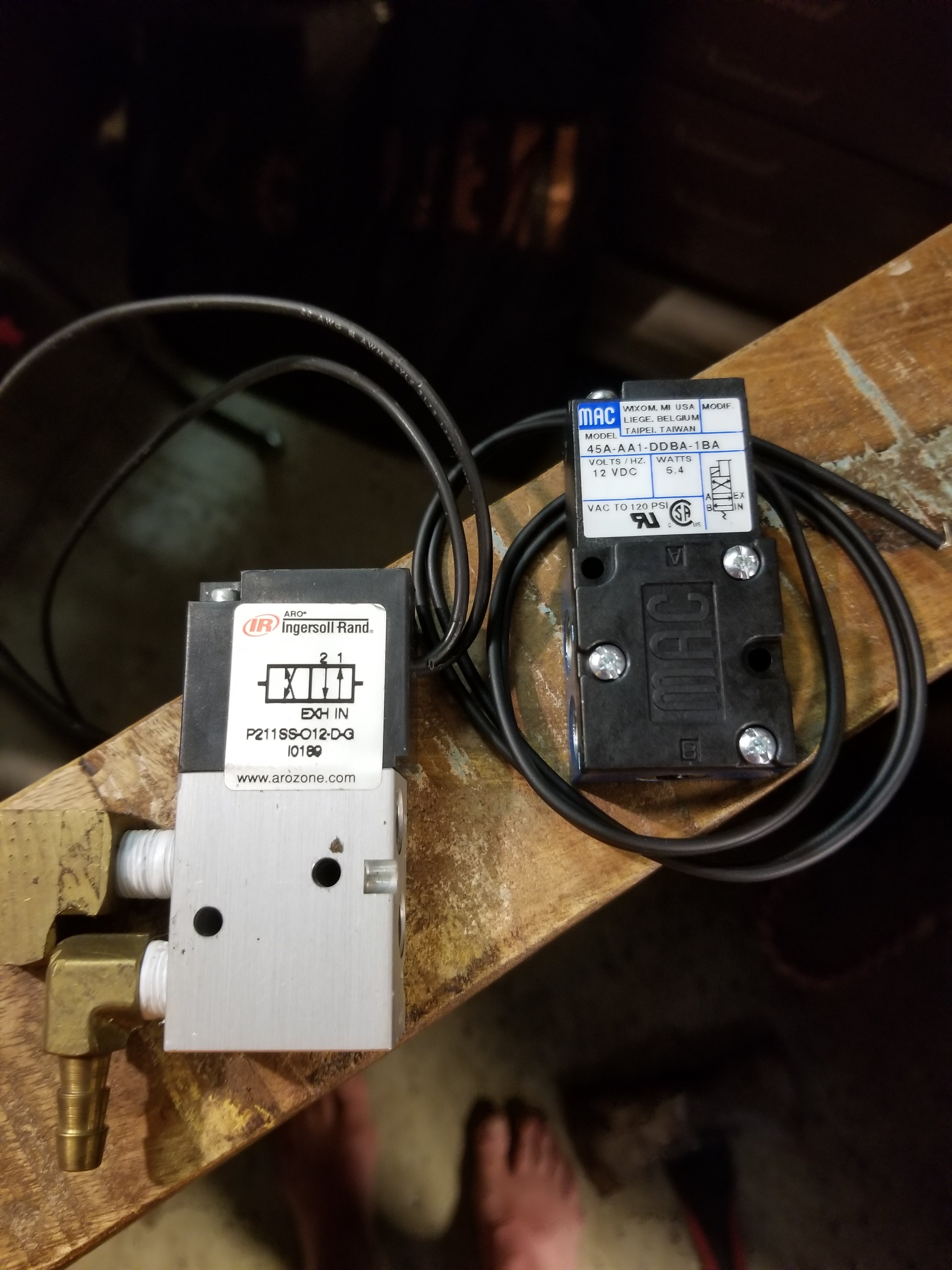

This what a MAC valve looks like.

Yes, that's the one. Mine looks slightly different but it has that diagram on it and it has the MAC inscription. I had it replaced a little more than a year ago. Probably too soon for it to go bad. So maybe the pods are the problem this time. When I pull on those cables that are connected to them , the idle will come up. But it won't stay when I release. Turning up the idle on the pod adjustment screws is counter clockwise, correct?
