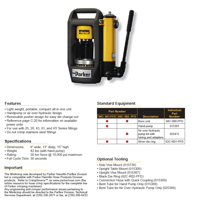

We use these to re-crimp our lines. They work really well.
