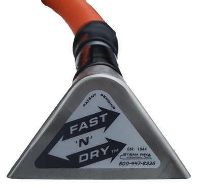

I wouldn't mind trying out this tool
Www.steamway.com/fine-upholstery-tool.html

I have had a tool similar to what Loren posted many years ago.
To be honest, I didn't like it, could not get between fixed cushions easily.

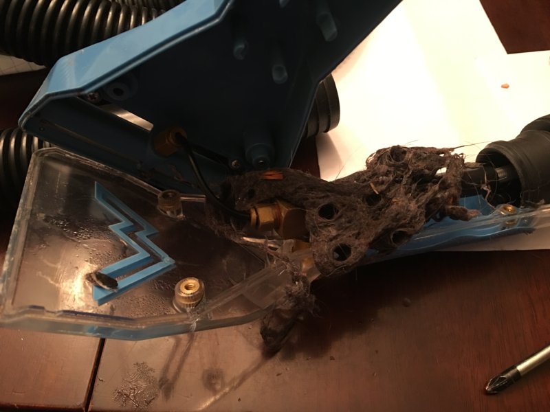

I bought one, because if they work good I would buy one for every truck. Not all that impressed. It clogs easily with hair and lint. And it leaks air from the needle valve Oring. We have to clean this thing out all the time.
