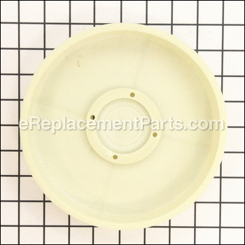

Anybody know where I can get a drive cup for my old Orbitec / CCS / Trinity Renewal Systems OP machine? John G. GAVE me the last one in his shop a few months ago and sez Clark will not sell him more. Clark is not answering his phone.
These plastic cups crack when helpers repeatedly drop the machine on its drive plate when unloading it from the van.
This old machine is still going strong and I use it a lot, but it will be out of commission when this last cup breaks.

Does it look like this?

The oreck orbiter cup will fit the orbitec machine.
Nate, Clark still owns Orbitec, don't know if he is planning on selling or not.
Johnny, John should have told you that the oreck cup would fit, that's where he bought his cups until Clark started having them made,
also, John is full of crap I'm sure Clark would sell him parts.

It's the brush holder for an Oreck Orbitor. Should fit the old CCS machines if I do recall, but check first.
ereplacementparts DOT com/brush-holder-pan-p-768410.html
Thanks, Haylie! I ordered one today.
