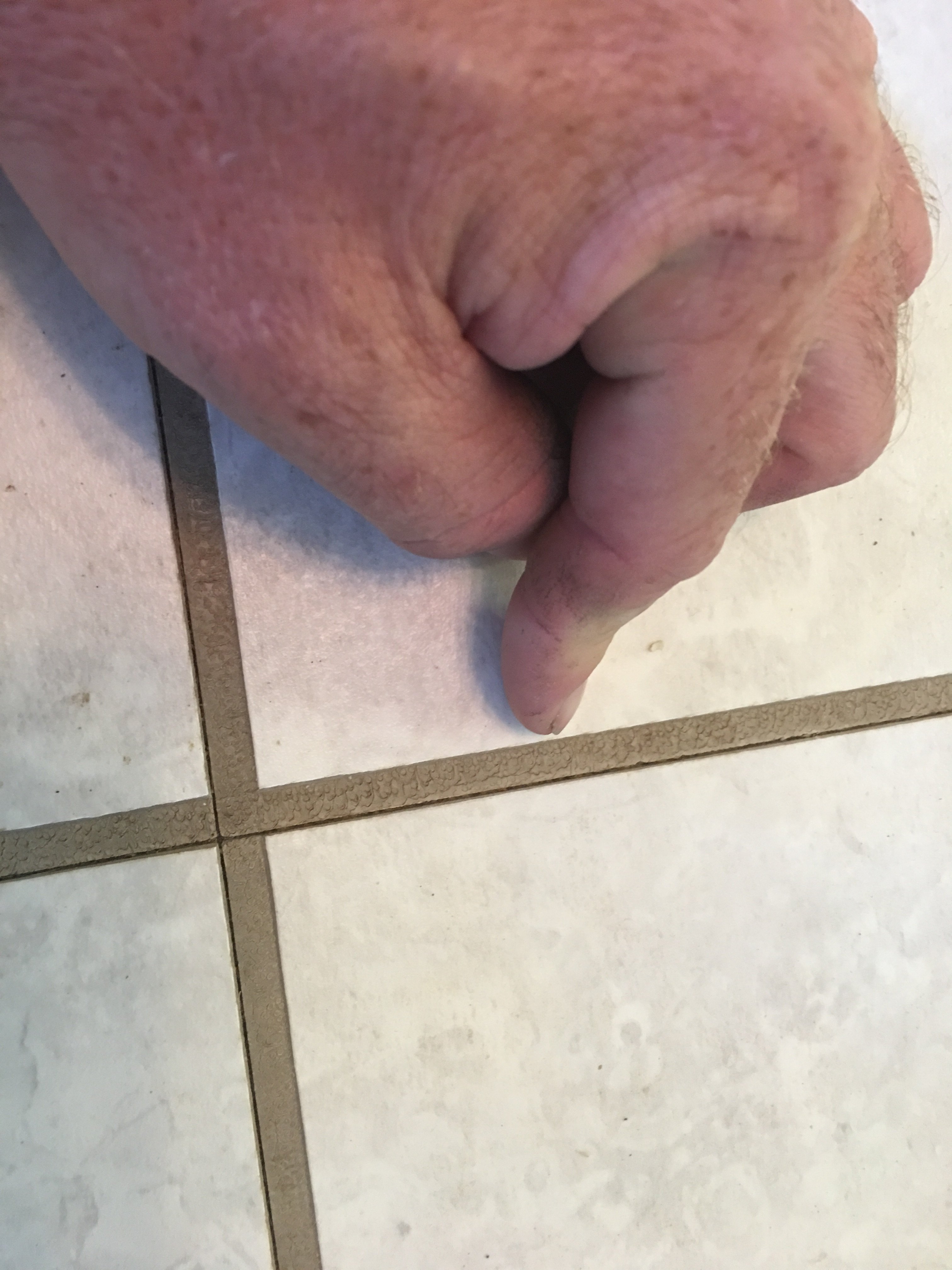

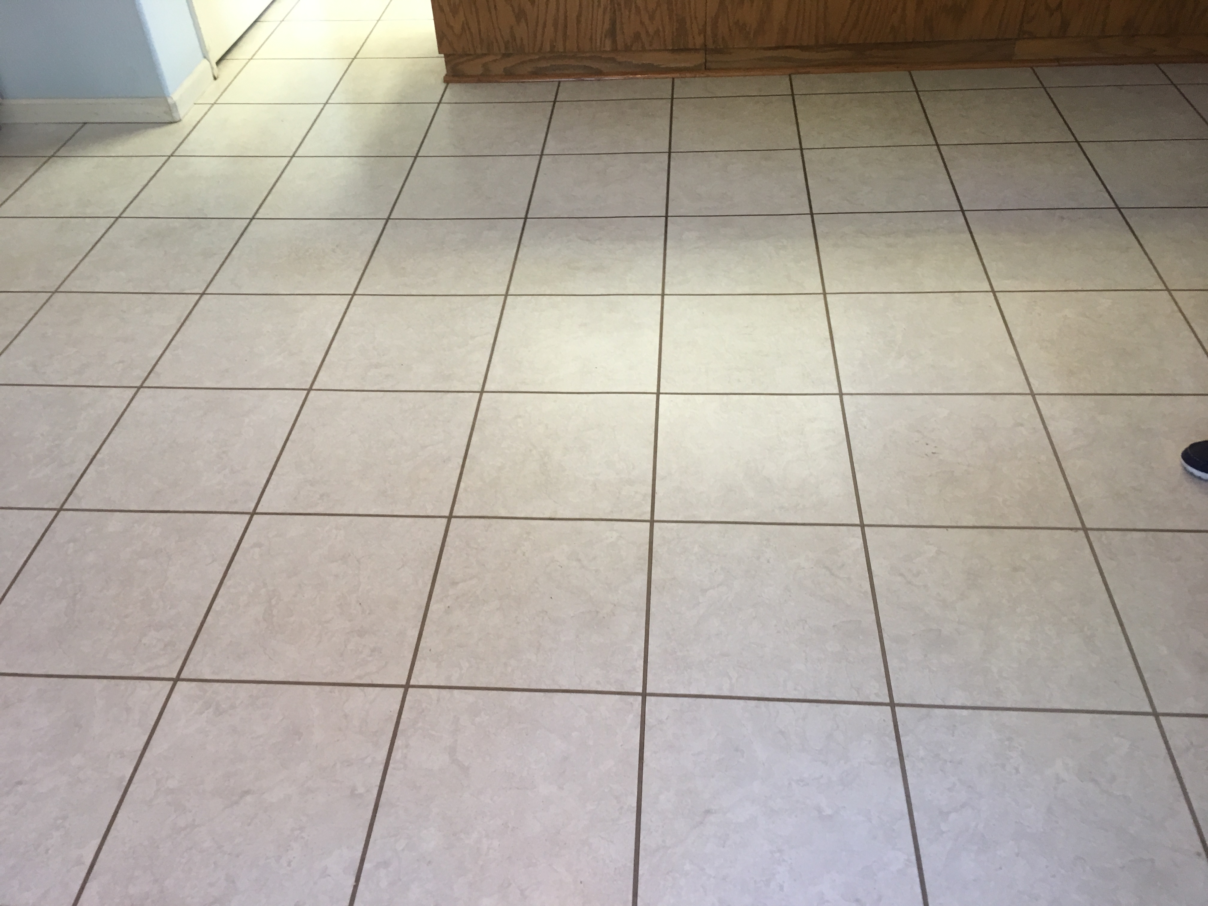

I’m cleaning this floor. The fake tiles are Vinyl flooring squares. I’m fearful to use my tile spinner or wand because there are small gaps between the edges of the tiles. My fear is the water will get down in the cracks and cause swelling, adhesive release or worse. I’m thinking I should use my orbot with a cotton bonnet and a neutral floor cleaner. Fast responses are appreciated.
23,898
Redding
I was advised that spinning it with the heat down should be okay. Still open to suggestions though.

Those are installed using pressure sensitive adhesive, same used on carpet tiles.

175, nuetral cleaner with MF and make lots of whirring noises so you can show how hard you are working. Collect check.
