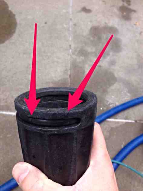

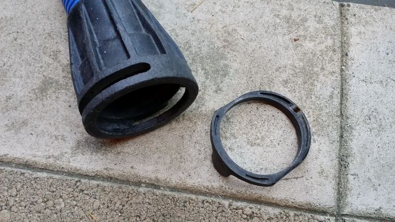

I didn't get them from you John, but I'll post a pic tomorrow. I have a 2" female piece that cracked near the button. I still really like them but definitely not perfect.
The Clean Machine
114,150
I had the Spring Ring from a 2.5 to 2 reducer fall out of our most used hose just today.
a few cracked rims too..View attachment 3619

Need more pictures I know there are more then this. Going to make some calls to my locals. Sometimes people don't feel it is worth the hassle to "complain" but it isn't complaining and I personally take it serious but I can' do anything if I don't know about it.

Here's my female 2" Flash Cuff. It has cracked in two places, on the rim and the piece that is connected to the release button. It has been stupid cold here this year so maybe that is it? It is also at the Devastator end of my lead hose so this particular piece is heavily used. By heavily used I mean almost daily for about 6 months....so not all that heavily used. I'm careful with my stuff but maybe I got jiggy with it at some point. It still works but I'm glad I ordered a few extra when I outfitted the 2 vans.

Yeah, the honeymoon is over for me too. They have become increasingly difficult to pull apart also. I outfitted both of my vans less than a year ago. I wouldn't exactly call them garbage, but there is definitely room for some improvement. Those female ends are fragile, especially in cold weather.
