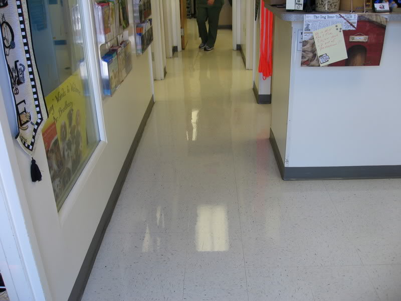

It sounds like the doctor wants it to stay clean and really have a nice shine all the time. We would strip and apply 3 coats of Spartan's I-shine. I would recommend buffing once every one or two weeks to keep it nice. I would then recommend a scrub and recoat in about 3 months. The scrub and recoat will build the base and give it more gloss and more depth. We get a nice shine off the mop, but burnishing sill make it "pop" after about 3 or 4 times, and the scrub and recoat will give that nice depth. We have people come in and look at our dry floors and ask if it is safe to walk on them. Here is a picture of what we get in the end. I'm not posting this for brags, but so you can see what our system gives us in the end.
As for the price, we would probably be between .30 and .50 psf depending on condition, how crowded it is, if there is a place to move stuff to, if we move it or if they do, and what equipment we can use. We won't make a whole lot on the strip, but when set up properly, you make it back on maintenance which is very low in overhead.

The picture above I just posted as an example. That is an animal hospital that takes a real beating. That picture was taken about 3 years after it was stripped. We buff once a week, and scrub and recoat two to three times per year. It has now been four years since it was stripped, and we are just about to scrub and recoat. I hope to get another year or two before we strip. I'll try to get some pictures after we scrub it this time too.
We rarely ever apply more than three coats at one time, but this is because of the finish we use. The I-shine we use is a high solids finish and if you apply too much at one time it will streak on you.
