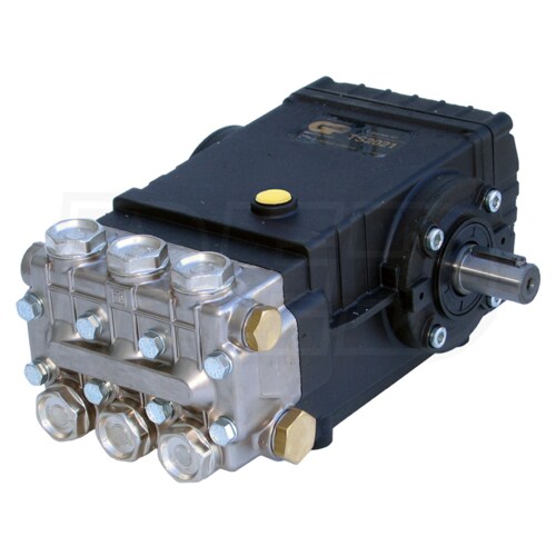

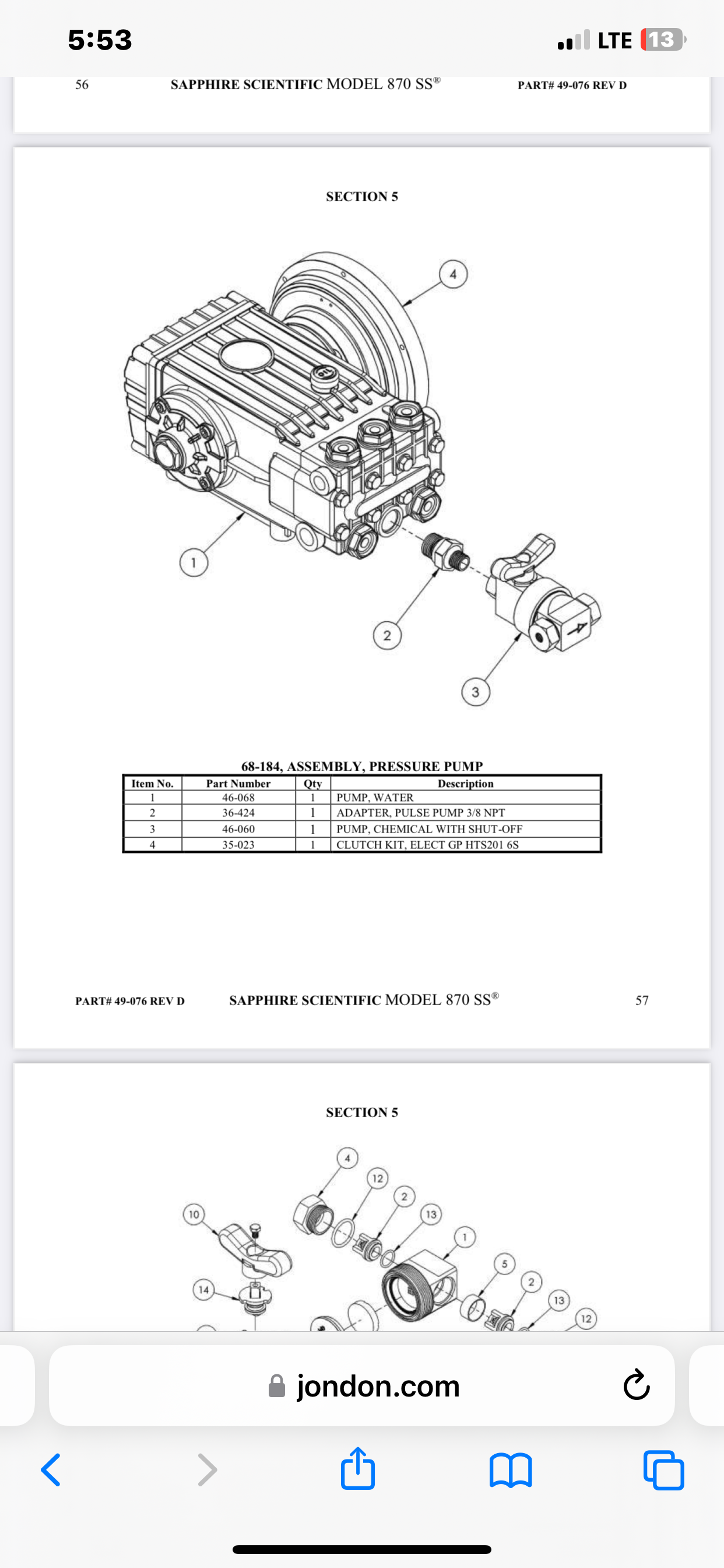

So looks like the GP high pressure water pump took a crap on my 870. Started making a hammering noise and the pressure was all over the place. I thought it was air in the lines until i checked the oil. Lots of metal chunks in there. 5000 hours on the pump and today it decided to die.
So @FredC. Just want to double check. What is the correct pum I should order.

Look at kleen rite price on pumps carry most

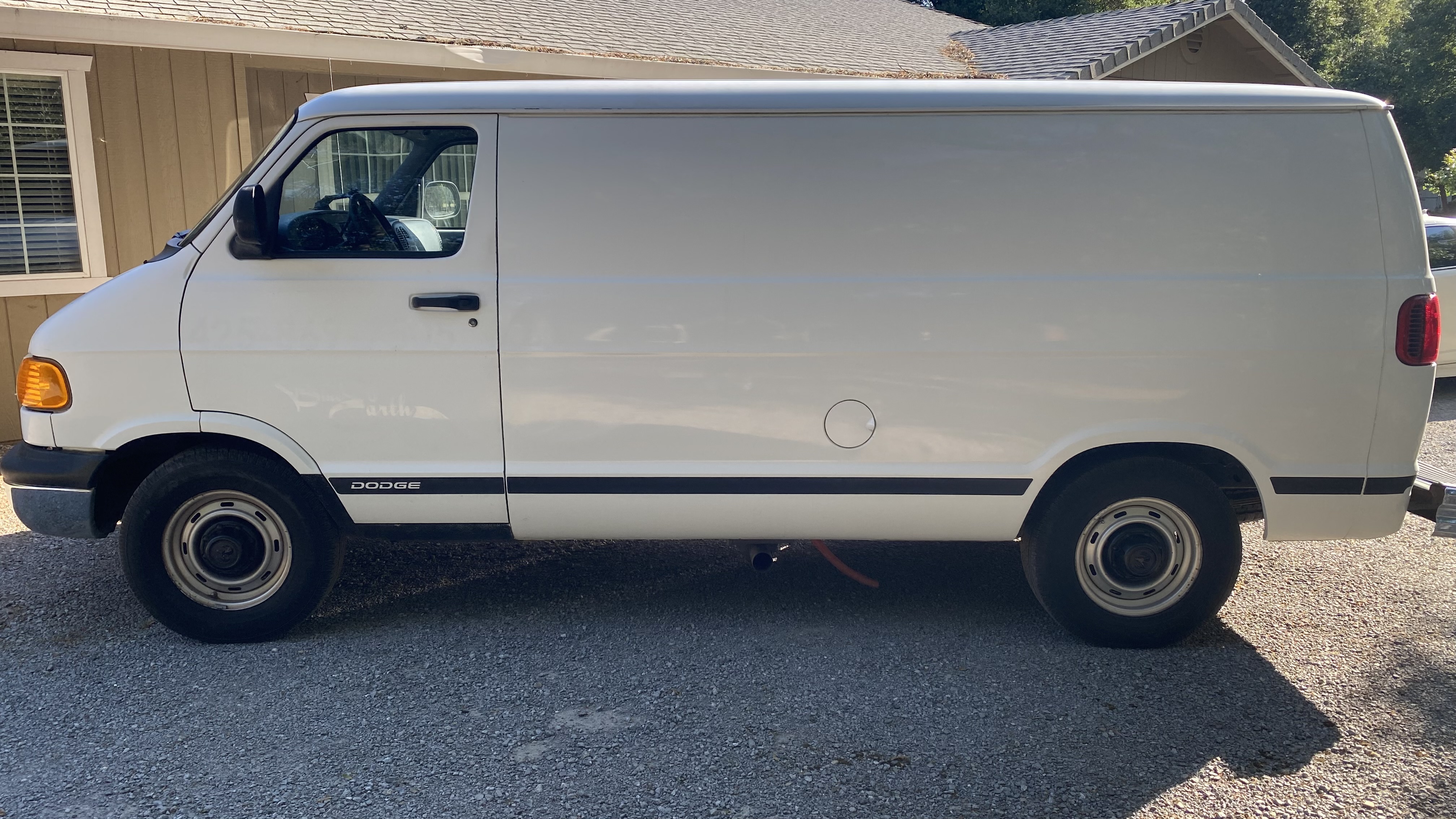

Got the new pump in the 870 and we're chunking right along. Got a line on a Butler van I may purchase. Thinking about bringing on a couple of guys and then letting them hack out the jobs. I have more work than I want right now. I just want to stay home and trade my options. I keep asking myself why am I still cleaning. I must really hate myself.
