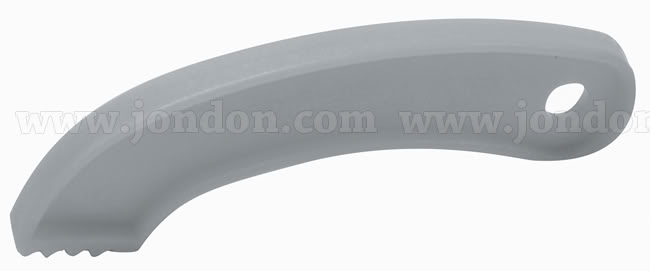

Have a helper pretreat the hard thick spot as many as he can. turn up heat and go for it. Reapply to tough ones and go back to it. a gum scraper or bone scraper will help also.

De'Lime gel, then a knife blade edge on top twisted/rotated ...or sawtooth gumgetter
