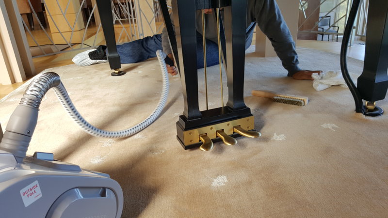

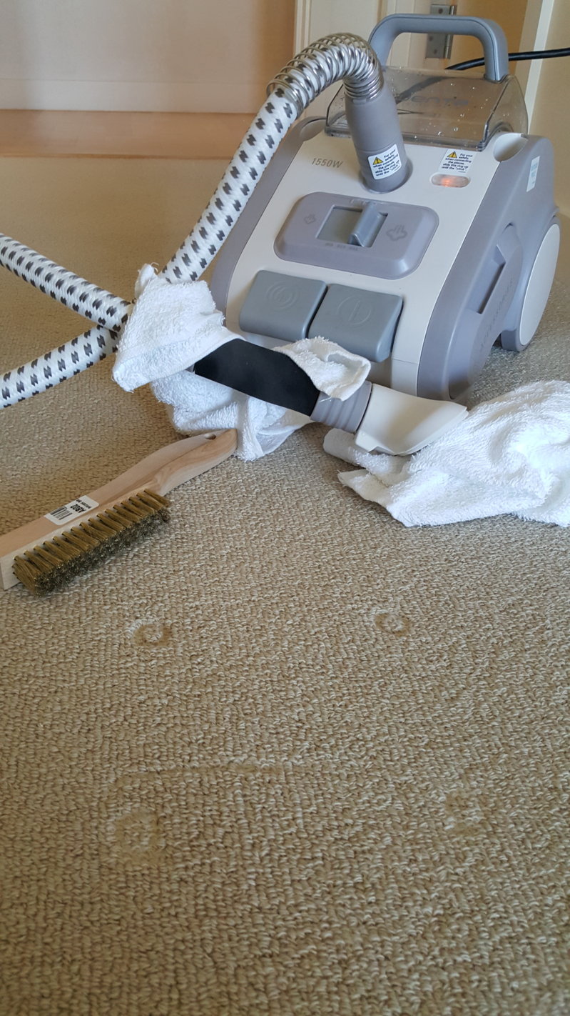

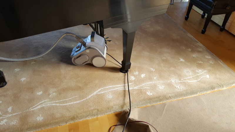

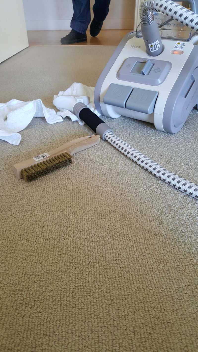

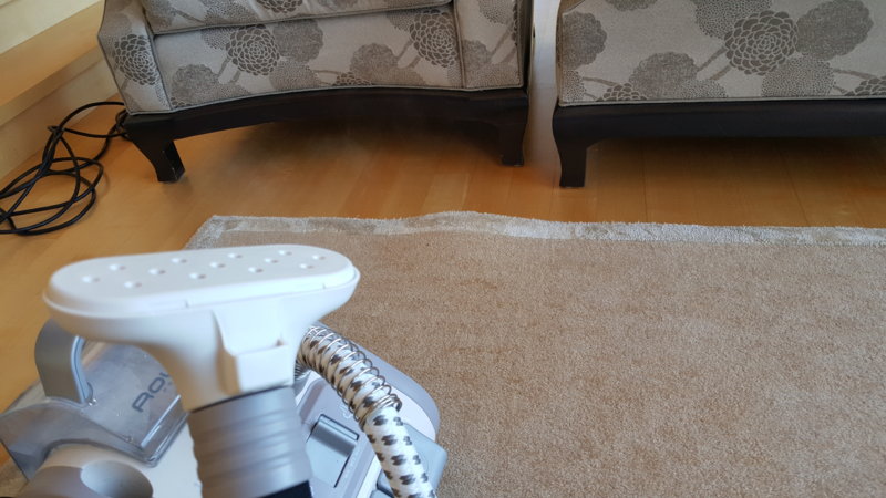

View attachment 14271 View attachment 14272 View attachment 14273 View attachment 14274 View attachment 14275 At least when cleaning wool and rayons
We had two wool/ silks ripple on us overnight. We Jiffied the backing then the yarns to completely flatten out the edges in just minutes.
Lifted Silk inlays realy nice as well.
Dents left from fans and furniture popped up in one pass..
One should be on every truck. One of the most underappreciated tools in our industry.

Those rugs came out BEAUTIFUL.
When the The Designer and Philanthropist home owner see them next week I expect a call or two. This home is just the first of quite the collection.
