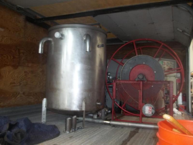

in a buddy's truck at A/T HQ. They're re-plumbing it and a bunch of other stuff too.
I'd sure like to ditch my dual round tanks and get a new single tank myself. he said it cost about $2200.

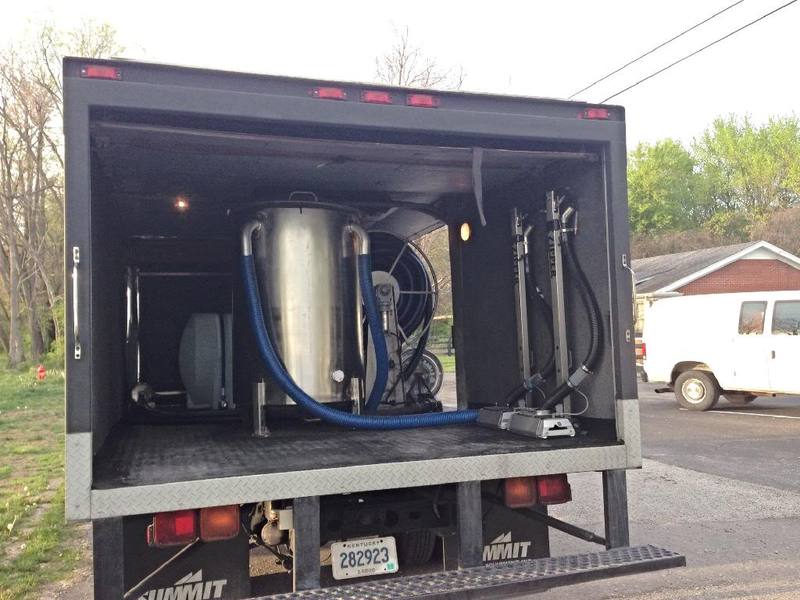

I modified one of the dual flat bottom tanks in my 777 with a cone bottom... along with a complete tear-out to copy modern A/T's ;)

Also, Judging by how much work this took me, I would have charged $1000 bucks to do all the work.
Cutting out the baffles was a PITA!
I wish i would have just ordered a new one from A/T :/

For the paint, I coated it in citrus strip and then wrapped it in Saran Wrap for a few days, this lifted all the paint off, and I just pressure washed it.
After all the welding/grinding etc,
I used an orbital sander and wet sanded it with 400grit paper.
This have it a super smooth matte finish with no swirl marks.
