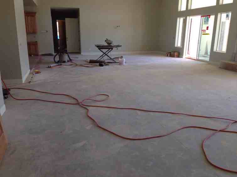

Owners asking builder to have cement clean construction dirt and dust 4000 sq ft
11,516
What do ya do besides vacuum and steam with a glide big glops of crap should I worry??? This is why I stick to xarpet
Is that a concrete floor? Almost looks like a particle board subfloor.
If you have a HEPA vacuum I'd go over it with the vacuum first the rinse with your wand. We prefer the one with a brush head but if a glide will work without too much damage I'd use it.
Fast easy, use an airmover as you clean and it will be nearly dry by the time you finish. Although you mentioned big gobs of crap, you might need a 175 and pad to bust that up. Add in for the extra time if that is the case.
Charge? Keep track of hourly but then break it up to sq/ft at a price that you are comfortable with. You won't have much in the way of chems so it should be less than carpet cleaning.

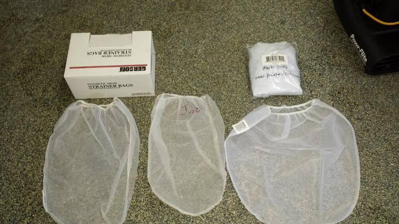

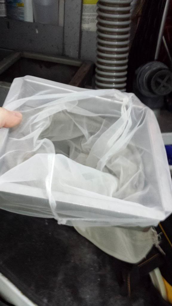

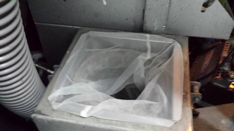

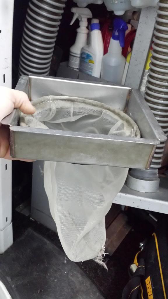

Also, you are going to go through filter bags....we use throw away paint strainer bags (5 gallon)
Not sure your going rate, but we charged .50 cents per square foot on this weeks, but looking at yours....It is going to be a lot more work!
Best wishes on the adventure, but you can get it done and make some money!

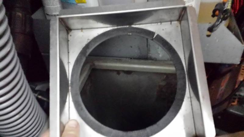

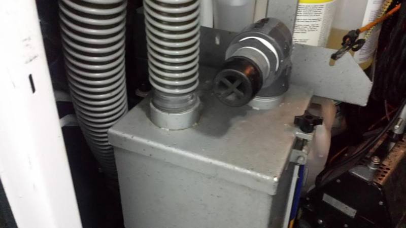

I'm getting the 5 gallon filter bags (that I make as throw away daily) from http://www.painterdeal.com/filter.html
Get item SB-501...the other numbers are for the amount wanted....you can also get 5 gallon paint strainers from home depot, but they are 3 times the price in reality. The ones on the right are the Painterdeal units. Much larger!
On my Butler unit rear waste bag clean out

Ya it's all cement they have some covered but dust and debree everywhere. Thanks for input. I don't know if there's electricity have to find out when they call
