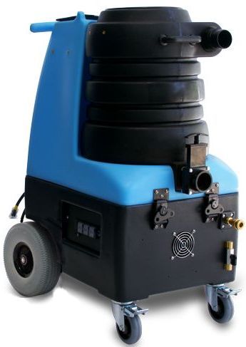

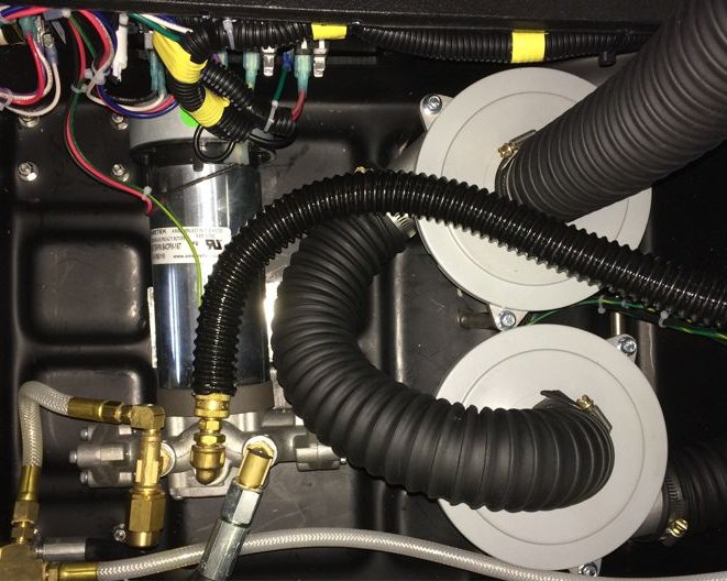

John @ Mytee & I have been testing various portables for actual performance with the wand on the carpet for many months. Today, I tested a new machine with totally new vacuum motors. I was shocked at the results ! It was 22% better than the highest performance portables I have tested before (including 2, 3, & 4 vac motors). It uses a new vac not previously used in extractors. It should allow a portable with a 14" wand (16% wider) to clean better than previous extractors with a 12" wand . It was a two cord machine, and it included a 400 PSI Cat Pump System at a reasonable price.

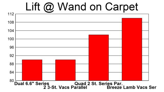

On some jobs TM's can not be used. Tested on level-loop nylon with 12" Wand.
11,202
So the those are two different configurations series and parallel on the 6.6 lambs and it's the same either way?

Isn't that just a Mytee Breeze with two 8.4's? If so I'm interested because the breeze was discontinued right? I always thought the Breeze was a nice balance of weight to performance.
27,451
Can't beat that price. That's about what we pay for a basic Ninja here with 2 2 stage and 150 psi. Is it available with autofill/pump out?

................need to figure out how to fit twin 6.6's on the underbelly of Mytee's new units like they do with the 5.7's.
That's something that's guaranteed to get peoples attention.
Wouldn't it be so much easier too?
No, these new Lamb vacs have to be in series.
The Speedster vacs are in parallel.
