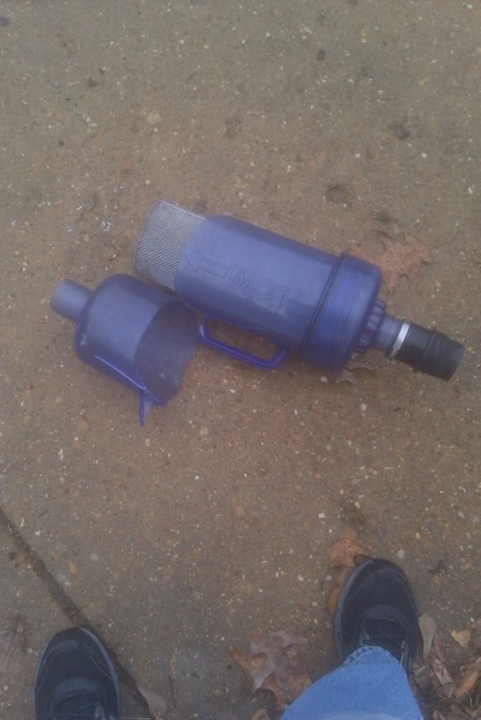

Well the screen mesh busted but the real issue is the lid.
It gets stuck and you can't get it off. Dirt and grit get caught in the grooves and make it impossible to twist the lid off.
I had two that I had to knock the handle on a post to get the lid off, but eventually the filter just cracked in half.
It's junk.
The older flip top is a good filter. Just keep the orings changed out and the filter will last a long time.

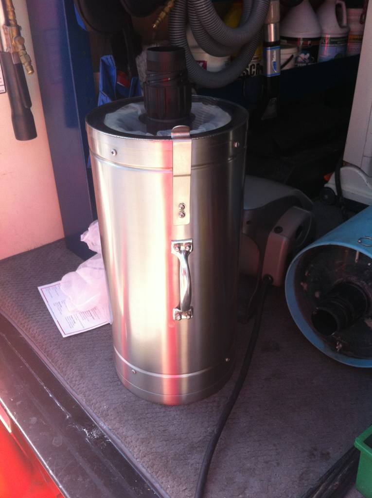

I personally would get a box similar to what Jim Martin has.

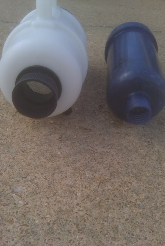

If you want an inline you can't go wrong with the mytee, but you should know this because you have some mytees.
I have two but have not put them into service yet.
Anything wrong with them I should know about?
And the real reason you want the 2.5 inch inlet mytee filter is better airflow. Just look at the difference.

Thank you for the photos Dan. I thought they were supposed to me made of bullet proof plastic? I guess not. Great point made of the screw offs becoming filled with particulates. I'm going to return this HF 2 and will get a devastator made by Conway instead.
