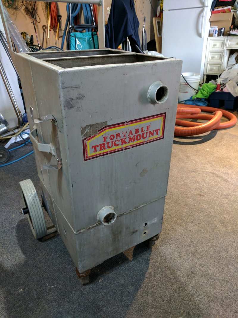

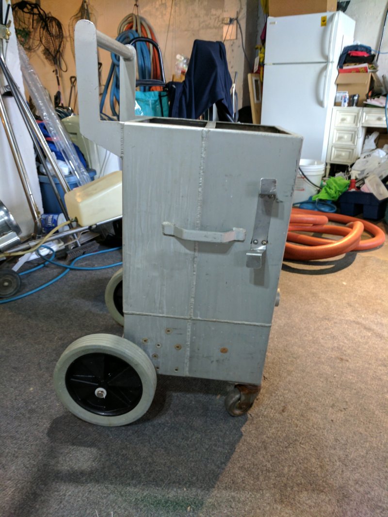

I picked up this portable yesterday. I think it will be the perfect shell for my new (little monster). Planning to install a Pumptec m58 1/2 HP 500 psi pump and 2 3 stage 5.7 inch vac motors (13.5 amp) in parallel. Have a pump for the auto pump out and am working on the auto fill/Chem feed. The fresh water tank is pitted and leaking. There was a fibreglass liner which I removed as it was in poor condition. I will have to refibreglass it. Anyone have any ideas on a good fibreglassing technique over aluminum?
