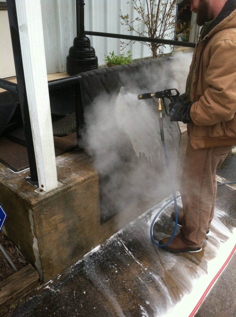

I picked this little hand tool up at TCS last week. I figured it would be useful for vertical tile surfaces and corners, but I used it today for cleaning commercial mats.

I don't know who makes it, but it has an adjustable fan pattern and a high and low flow adjustment on it. I have a commercial bathroom to clean next week and I'm using it on the walls instead of a counter spinner.

I can see how the dual adjustability would make it unique.
Never came across an adjustable one.
Ive seen several commercial/janitorial bathroom cleaning units that follow the "hose down" and "suck up" methodology.
More interim maintenance/disenfecting than a deep cleaning I think.
