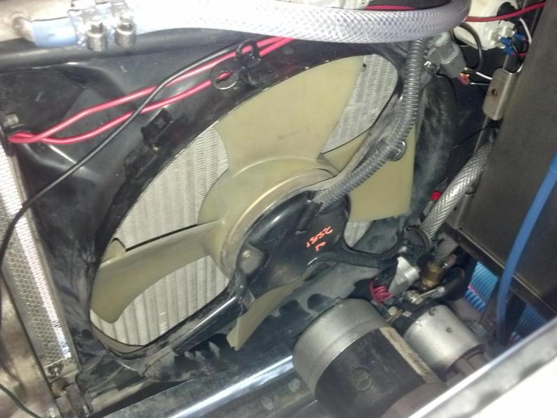

this is kinda off topic but for anybody running a air cooled unit in a warmer climate you can do this. Maybe look into a smaller Quad Radiator or go kart, you could even use a trans cooler. If you can mount it where the motor draws in its fresh air.
What you do is take your fresh water hook up and plumb it to one of the ports on radiator then from radiator back to where your fresh feeds your machine, as you use the water cool water flows through the radiator and the fan or motor fan can draw very very cool air to blow over your engine. My PC has 3400 hrs on it. O and Marty it is on its way to you
I had to do something as Redding gets very hot in the summer today it was 104-105, after doing this my vw oil temp stays at 200* or less, I am going to do the same for the legend as it never fails every other summer I have to get new coils for the kohler due to overheat issues

I bet you would get 4000 hours on your engine if you did that plus you could have that thing running while you tear down and the van wouldn't be so hot on the way to the next job.
