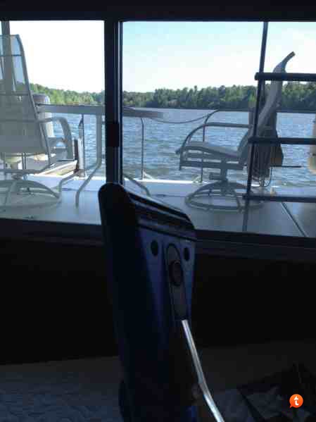

That slip at that marina was going to be a 700 ft hose run. Usually boats can be moved close enough to be reached by the truck.
Justin was not a happy camper going back with a porty, but the scenery was great!

Best to leave the machine on the dock when doing boats with a portable. Usually enough different access points to easially reach anywhere inside.
I have done smaller boats entirely with a stair tool if too tight for a full size wand.
Be sure to secure it well so it doesn't wind up in the drink if any of the hoses gets pulled on.
A marine-to-standard plug adapter can come in very handy too.
