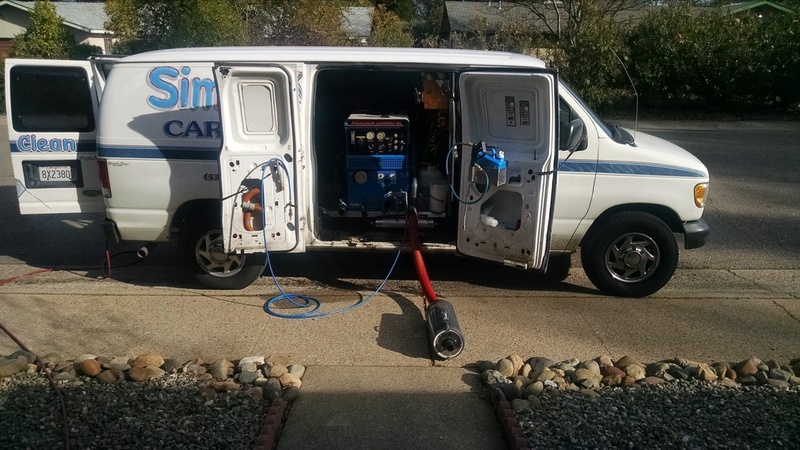

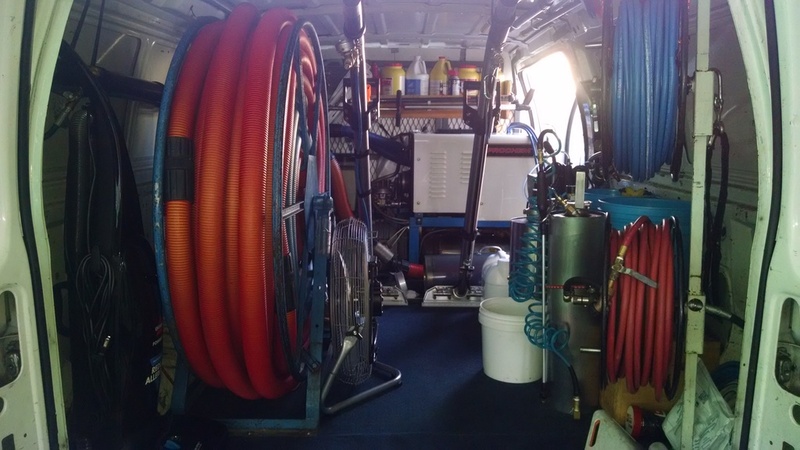

Man I just used up ALL and I mean ALL my luck for 2016.
If any of you have a leaky rear main seal I would HIGHLY recommend fixing it NOW. I just spent all day Saturday doing a full descale flush, new oil and filter, plugs, air filter, cleaned up my van getting everything nice and ready for this work week.
I had to come down out of condo I was working on to make a return call when all the sudden a ton of smoke came pouring out of my van!!!

Man I am just so stinking fortunate IT WAS SCARY AS HELL WHEN I SAW THE FLAMES things got REAL.....REAL QUICK.

Heat exchanger cooked the oil to flame level. Thank goodness you caught it in time !!
The oil was falling right on the HX diverter and it was HOT my water temp gauge was pegged, I was in the process of cooling it down when the smoke cloud poured out of the van, I stuck my body through the side door to see what was going on and it just boom fire!!! That diverter valve was flipping HOT

I called at 5:05 to my local repair shop, he was kind enough to answer after close but he had already shut everything down, So first thing in morning he is gonna call me back, It really isn't that hard a fix, just have to pull the pulleys off. The main seal is right there don't even have to take off any body parts so if it is in stock should be up in running by the afternoon.....crossing my fingers

I spent Saturday cleaning up my van and Tm bummer it is gonna take longer tryin to get all the dumped oil out the bottom of her now it is a flipping mess

Well 8 hours later and back at it in the same spot, finished up this one and one other I couldn't get to because of the BBQ I had going on. I was able to take the seal down to NAPA auto parts store they cross checked numbers and had two seals so I bought them both just in case I screwed the first one up.
