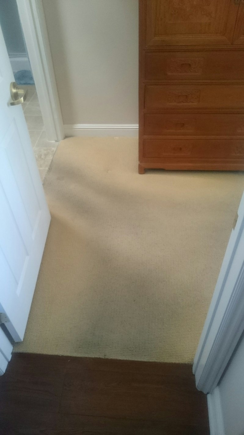

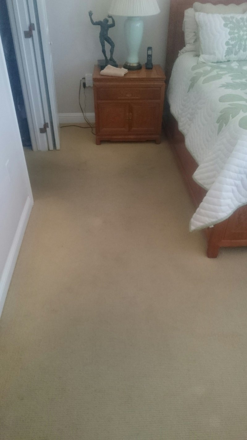

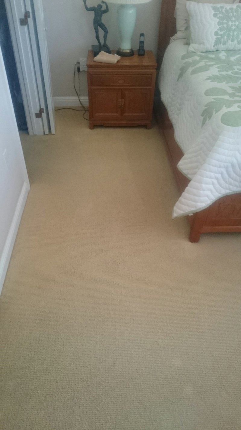

I figured I would take a few pictures of what I did today in a house where it "needed to be dry quickly".

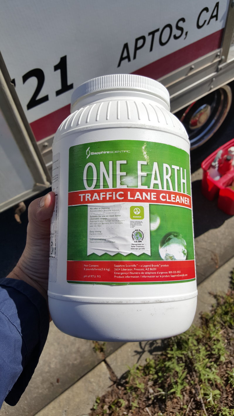

Since I won the One Earth package....
I will be upfront and honest: I did add 3 ounces of Trashed Green liquid to the 1.5 gallon of warm water and then I added 4 ounces of One Earth powder.
Presprayed with this stuff. Ran the 10inch crb on it and then microfiber padded it followed by cotton pad.
That's it.

No extraction. It is labeled as a viable low moisture cleaning juice so I just did that the past few weeks on several jobs.
Yes Marty, wringing out the microfiber pads, reveals the fact that a lot of dirt is being extracted.

I don't know what's in it.... But what I do know is this: this stuff makes my pump up sprayer's brass bleed green. Procyon with trashed green does not drip green.
