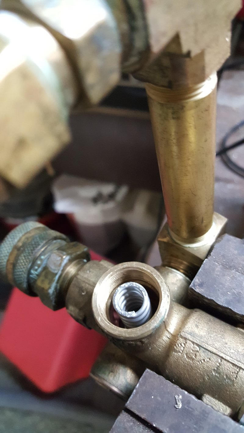

Had tile and carpet Wed am .. I was having issues with pressure regulator .. same here - turning it up it jumped up to 1200 then bounced to 800 as I spun it back with no progressive movement. I tried turning it down to 400 but it didnt drop but the black handle damn near spun off .. then finally dropped down to 0. I thought the reguator was shot after 4years since last replacement.
I bought another and replaced the wacky one and while I was dismantling the regulator I discovered signs of metal shavings but no shavings. Im thinking itll end up in my check valves some day. After replacing with a new regulator it works perfectly. Pressure rises as you spin the handle without a sudden burst from 4 to 1200psi.
I have a Hurricane TM so I became a contortionist for a couple of hours. Parts were burried between a panel, water tank and behind the engine. 1st pic is the bypass barb fitting, 2nd pic is 1/4 in threaded inbetween parts piece (missing a partial thread), 3rd pic shows good size internal crack of pic 2
