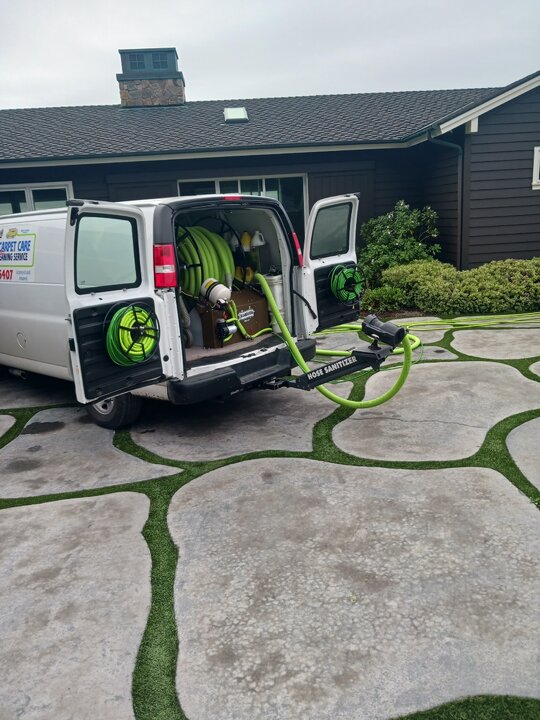

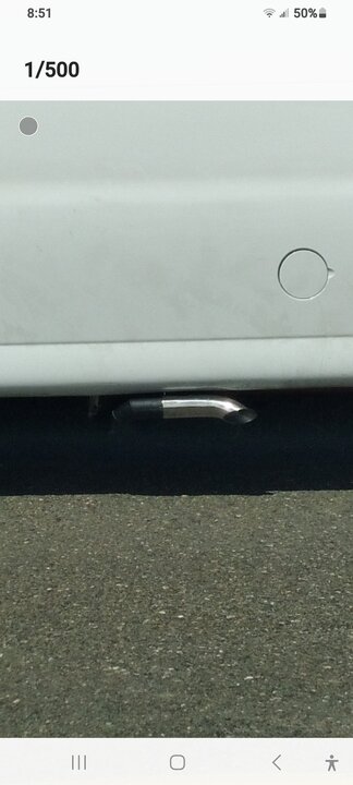

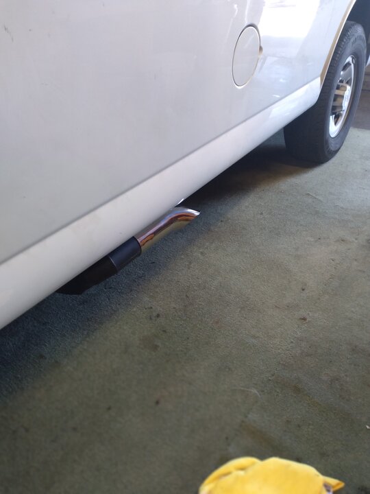

I burned up a bush by the front porch of my wealthiest customer years ago. Learned my lesson.
Before I showed up to this regular customers house i spent about 20 minutes redirecting the blower exhaust so as not to dry out and damage the grass grout in there driveway only to find oit when i arrived that they had replaced the real grass with astro turf several months earlier. They were impressed that i remembered and took the precautions ( got a 100.00 tip on a 500.00 upholstery job

You can use a small piece of plywood to off set the heat. Just remember to not leave it at the job or spray it bright orange
Leaving it on the job would be something id do. With my old machine i it would lay down cardboard incase of oil leaks. Several times i had to go back to retrieve it till i started placing a small piece between the windshield and wiper to remind myself to pick it up what ive done instead is the chrome tip is secured with a built-in clamp so i left the clamp just loose enough that i can stick the handle of my channel lock pliers into the exhaust and move it up or down but tight enough that it stays put
