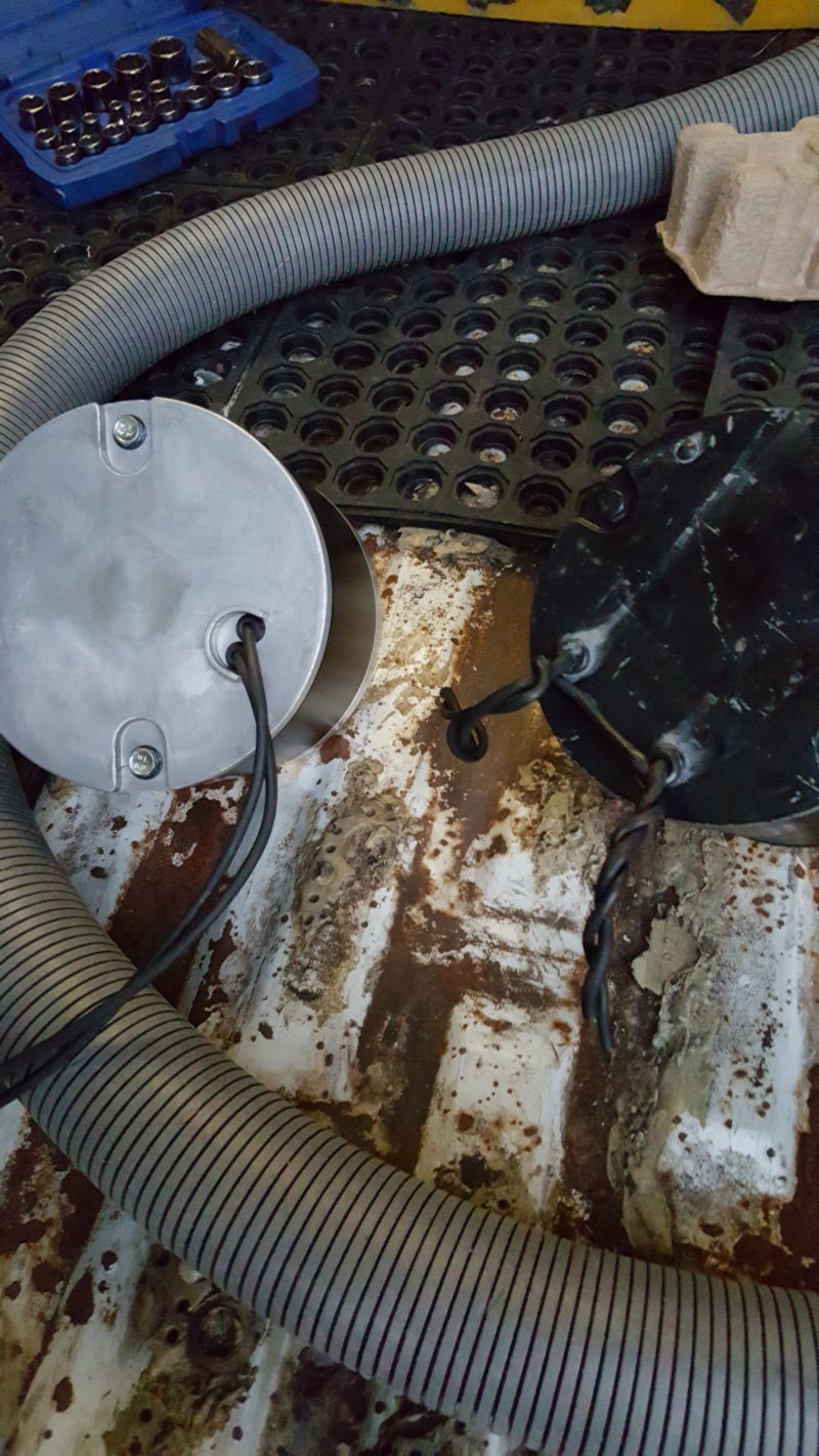

Old hose reel motor has 4 wires, new one only 2. Can I still use this new one? How do I wire it if I can?
7,040
oh- Geez! after looking at the photo again the 4 twisted wires seemed odd-- so I untwisted the wires and discovered that the new motor only has 2 wires. Im thinking the extra wire that was twisted around the other wires was the negative wire-- perhaps from the battery and the switch?
I don't believe there are 4 wires at all, I think it is just two wires.
Please unwind/untwist wire and repost pictures of the old motor with just 2 wires.

Yes that is correct-- so are both positive?
No you wire it(send power) one way it turns that way, wire it got the other way and it spins that way.
You can wire it either way depending on which way you want reel to turn.
Just put male connectors on motor leads and female on switch leads, so if it backwards you can just swap them easily.

So it would go:
Wire from positive on battery to switch, then from switch to either of the wires On the motor.?.
