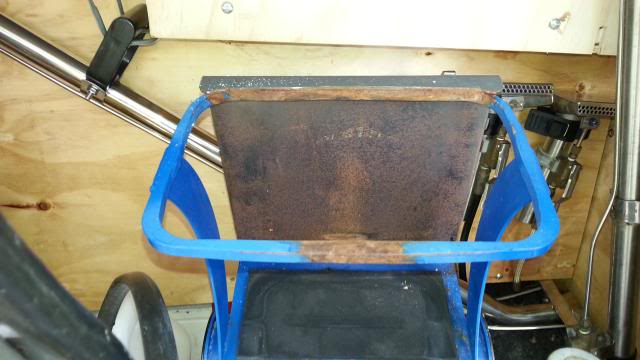

We took the Sprayborg off both of ours. lol
It just made it heavier, more awkward in tight areas and everyone got tired of the tight fit of the 2.5 jug.
Richard,
this is what I did many years back with the jug holder on my Sprayborg:
Prior to having the sign made for the front of where the jug goes, I had the front & rear steel cut.
It instantly sprung apart about an inch or more.
I then had another piece of steel welded into the area.
The jug now slips in & out very easy.
:yoda:
Shorty your improvements have helped so many! Thank you not only bettering the equipment we use to kake a living but for sharing.
