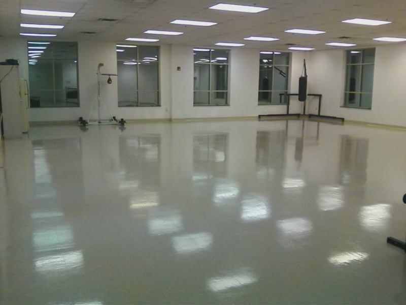

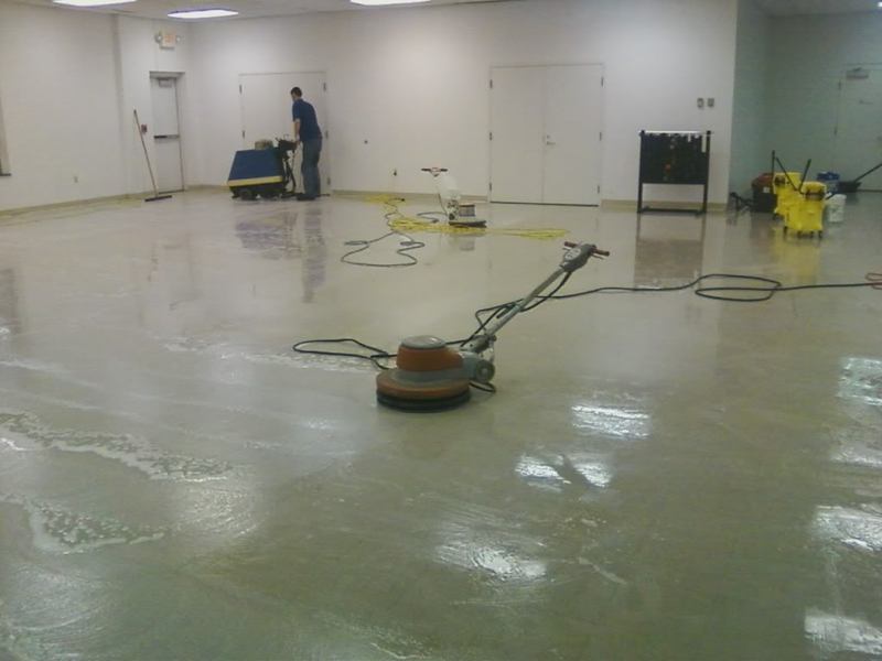

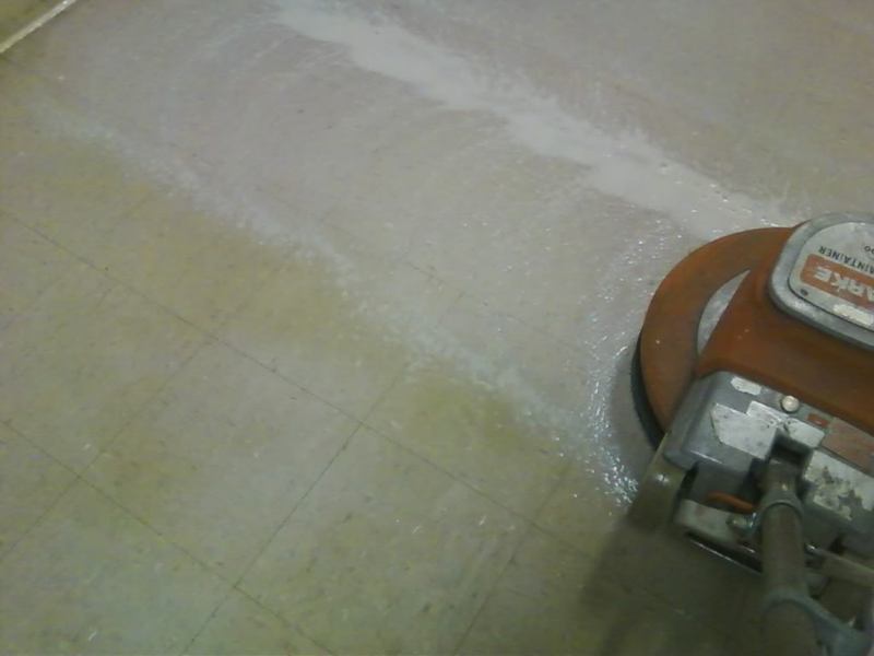

Just finished the job... The Bonesaw stripper & DimaondBack grit impregnated strip pads worked great! I normaly use about 7-8 gallons of stripper concentrate in this building, this time I used 2 1/4 gallons of concentrate. The tile was butt-nekkid in 2 passes and no stripper headache...
And the Elixer Floor finish lays out nicely& levels really well. I even tried to make mop lines... Couldn't do it and it goes a mile. I normally use about 9 gallons on 4 coats with I Shine but got the same shine with 3 coats (4.5 gallons)...

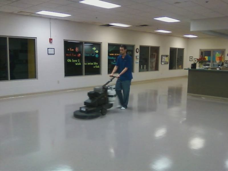

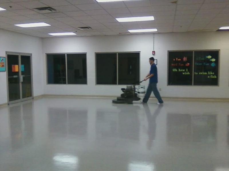

No it leveled out great... I actually tried to make mop lines & couldn't do it. I buff every coat to make sure it's as hard and reflective as possible. Buffing finish creates heat which helps cure the finish and has the beneficial by-products of making it shine better and allowing the following coat to spread more easily. Anyway, I thought it looked great for 3 coats.

Just remeber the 2 coats that are most important to buff are the 1st & the last... The others are just bonus shine. Oh & dust mop after you burnish, especially if you're laying more coats.

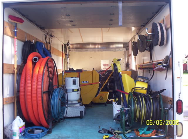

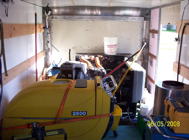

heres some pics of a loaded up van going to a strip job
Think i was on the way to do 2 family dollars, over 2 hrs away...i was staying over night then doing 1 the next day......
2 26"auto scrubbers.....a 24" propane stripper, 1 20" stripper(made to get close to edges)....3 mop buckets, wax bucket, some chems, and other misc tools...doodle bugs, scrappers, etc
Doug that's a lot of stuff in there, I thought you use to run a box truck?
2-autoscrubbers and a burnisher, you've got a good investment there! 8)

i do....here is most of the same stuff in the box truck....PLUS a TM
that was when i was running my TM stuff in a 6x10 trailer :| :| :| :| :|
oh this is before i put the everest in it...
