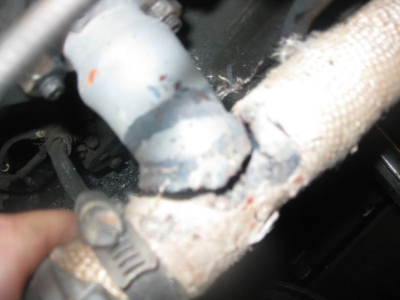

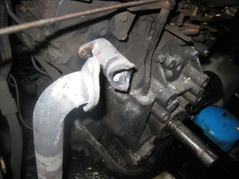

:x I replaced my exhaust about 8-10 months ago, and I'm about to do it again.. :?
It broke right at the weld.. I think my tm is getting too hot? Anyone have this problem?
Last time I replaced it I had it ceramic coated and I wraped it... no go.
The exhaust makes a mess of everything in my van. :evil:
Why do you guys think this is happening?

looks to me like it is a bad vibration.........you either don't have it supported correctly...or it is supported and it is to ridged............

I looked at this before Keith took it apart and I don't believe it is running lean, if anything it is rich. The exhaust is quite black and messy as you can see by his pictures. I don't see how it could be a vibration issue. The pipe that goes down into the exchanger box is free floating in a rope type gasket. Looks to me like the weld was bad. Is that possible?
