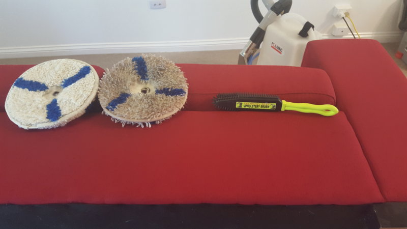

SHorty, I also liked to see the Grime Reaper Brush in your photo. Great tool for removing pet hair and lint from fabric.
Reactions: Shorty
