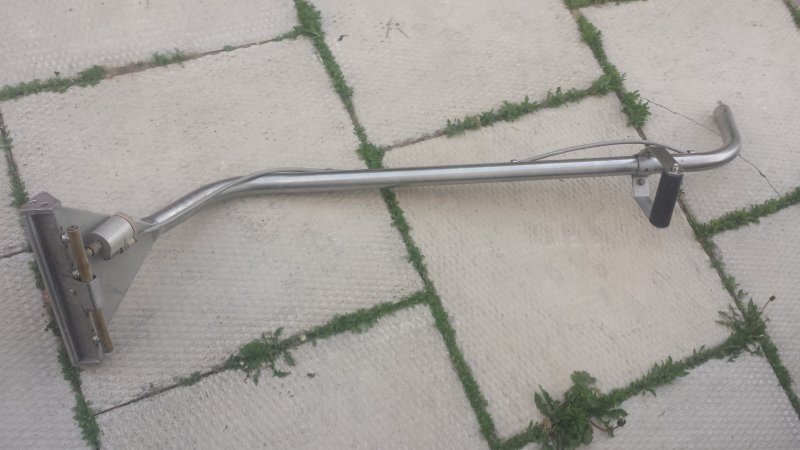

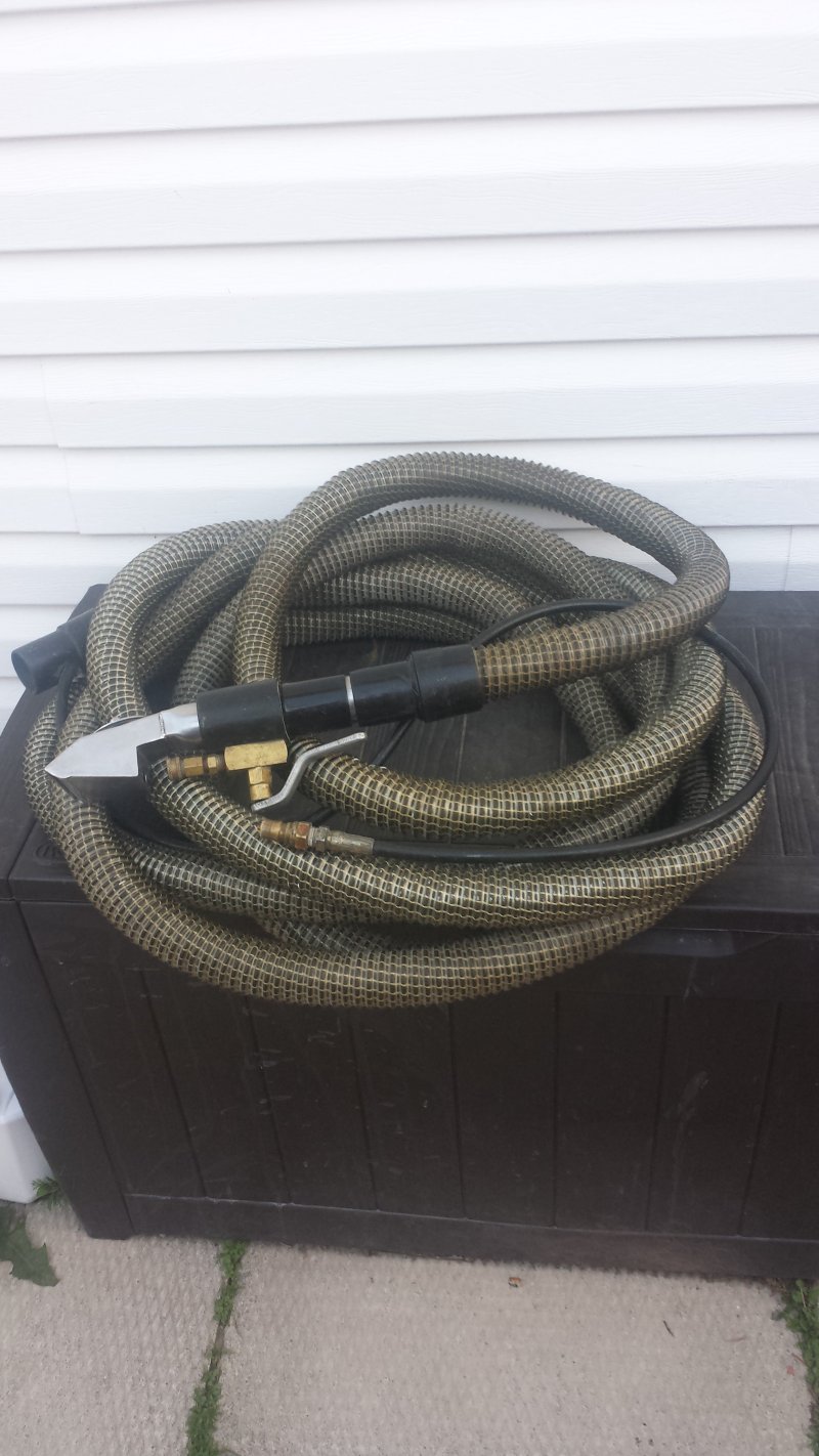

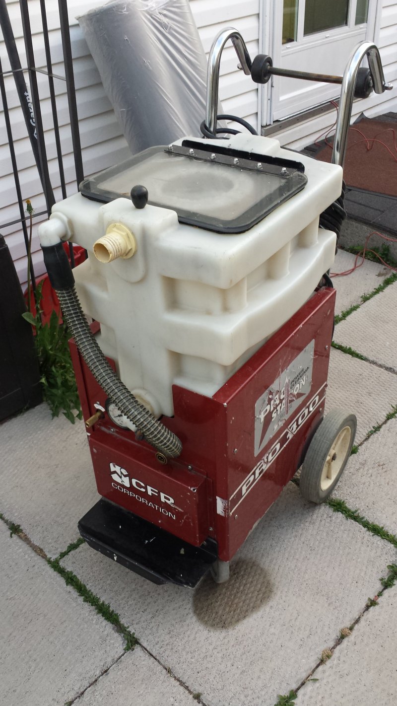

I took a few pictures. I'm very much considering repainting the aluminum side panels to give the machine a fresh look again, and reduce some of the anachronistic look if I were to use it professionally.
I removed the spray nozzle from the hand tool, which connected to a 1/4" quick connect, that the spray nozzle thread into. I'm assuming this is a standard spray nozzle? I must have put it down somewhere and haven't located it as of this posting. It seems like the newer CFR machines tout solution "atomizing" for faster recovery, which I'm not sure if that was a feature of this older model. The wand does seem to spray a pretty fine mist though. Also, these CFR's feature a solution "recovery" setup, that filters the solution and can be reused up to 7 times or so, which seems pretty unique. I'm so far very content with this purchase.
20150611_205447.jpg 20150611_210309.jpg 20150611_210506.jpg 20150611_210335.jpg

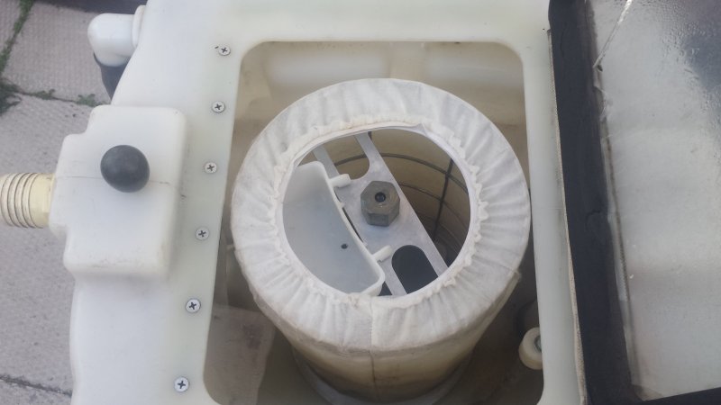

Thanks for the advice Danny. I think I see what you mean. I tried to clean out the tank and filters afterwards, and it was a fairly slow process (first time cleaning out tank), and not getting some of the used water, or filter debris around the work area was a challenge.
This machine was setup with that disposable light cloth filter as seen in the picture which stained up a bit. Below, there is a very fine stainless steel mesh screen that is held down tightly over a grey donut type of rubber spacer a few inches tall, with the center filter support shaft running through the center. The shaft seems to have a water inlet hole near the bottom side.
There was quite a bit of fine mud-like debris on top of this donut from lack of previous cleaning which made it past the stainless mesh. I'm trying to access the Pump Protection filter, which in the schematics should be just inside or under that grey spacer ring. Do you know if this piece just lifts out, or is the pump protection filter accessed elsewhere? I tried pulling it with some decent force but it doesn't really budge. This design does not seem to be the same as shown in the schematics on the website. I'll try to take some pictures.
