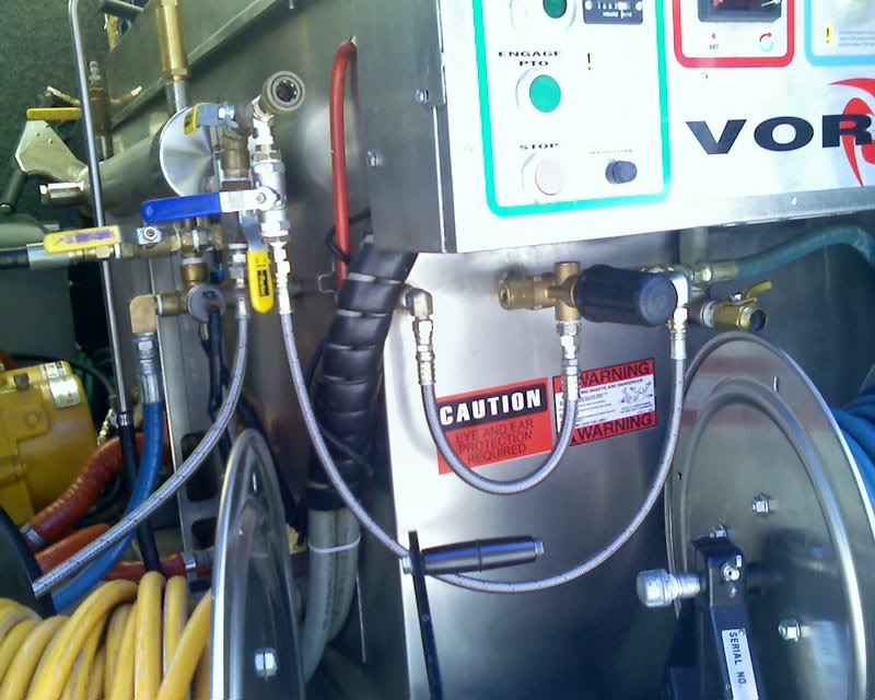

Finally got to pick up my 'new' Vortex yesterday. It's a 2004 720. A fellow cleaner decided to go with a quieter machine since most of his work is at night in big resorts.
I'll be spending the next couple weeks tweakin it out with all the extras: underbody boxes, new wands, extra hoses, wrap, ect ect.
Sooooo, any other pointers for me? I've still got my 05 AT so it should be interesting comparing these units side by side.
