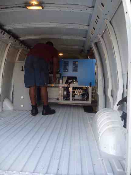

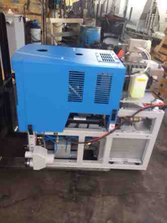

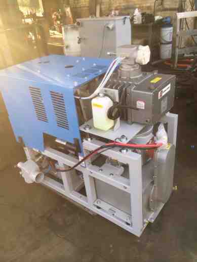

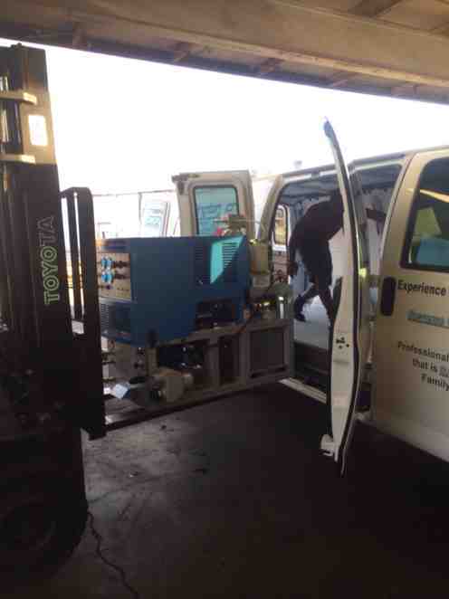

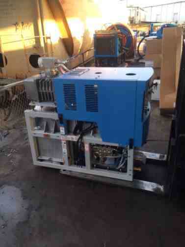

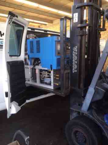

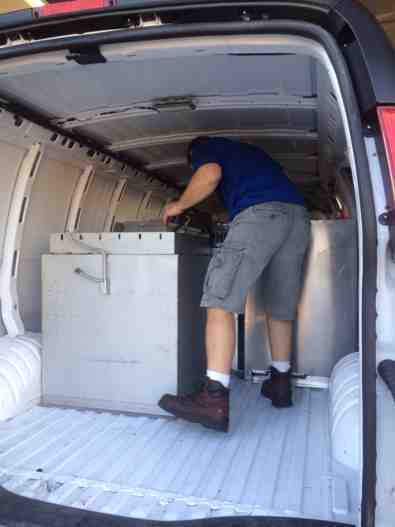

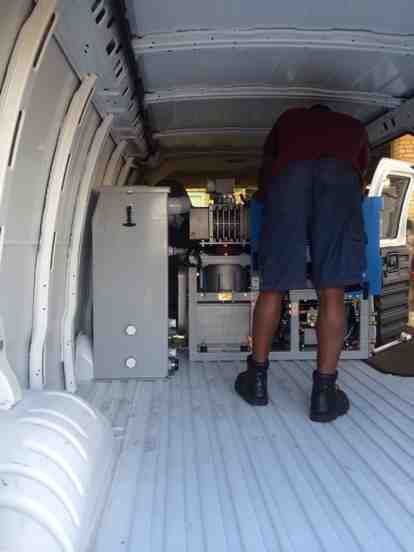

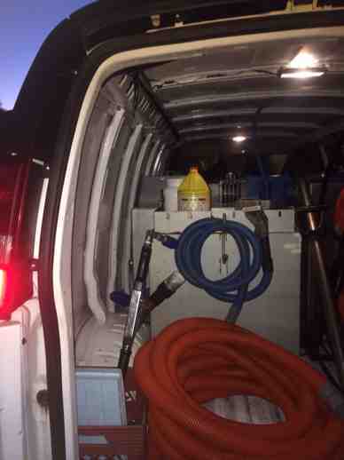

It's going in a new gmc 3500 extended with a. 6.0

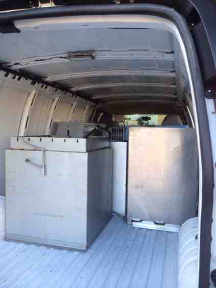

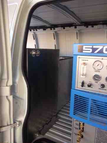

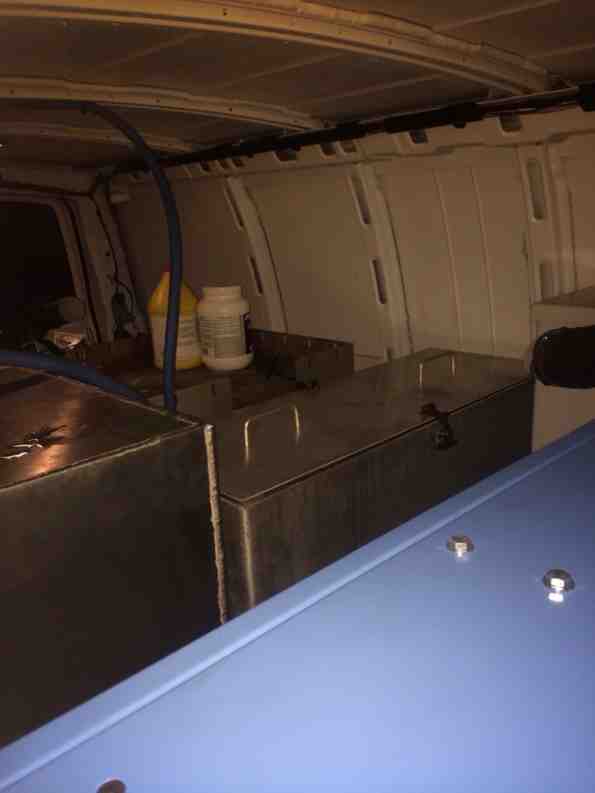

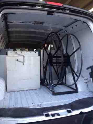

I had custom tanks made to give me my. 200 gallon fresh and waste cap.

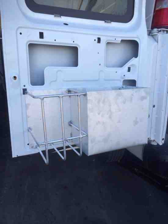

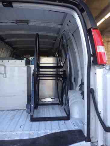

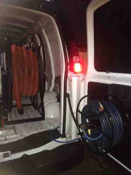

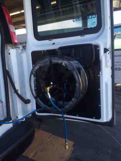

The solution reel will be live and mounted on the back door
I have a few shelves to build in. This is the layout it is being plumbed and installed today and tomorrow
I will post pics tomorrow too as I add stuff to it then in a week or so the final product
There is plenty of room for cimex and tools

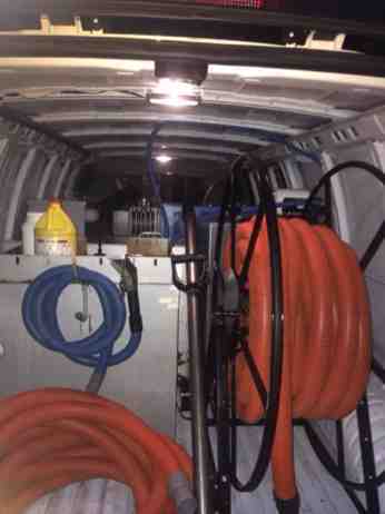

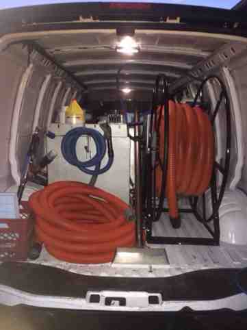

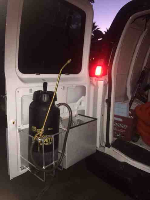

Looks great, I'd only put the hose you need and keep the spare off the reel, same with the sprayer, keep it empty if you can. It will be easier on the door and the hinges.

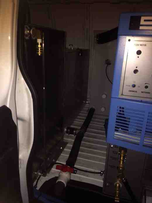

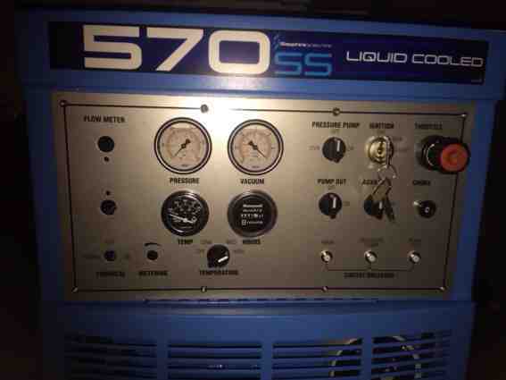

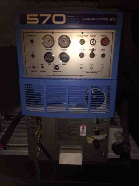

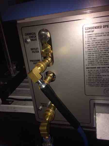

Looks good......your going to like that 570...the more I use it the more I like mine.....
Just make sure that you get a pressure regulator on the end of your fresh hose....or the pressure cap on the tank will pop...
I fought this for a long time and finally got tired of it.....put this regulator on my fresh hose and have not had a single issue since.......

I have a pump that feeds the system from the 200 gallon tank. I will keep a eye on it but I'm sure it has less pressure than the hose feed

The exposed area in the back will get a throw rug and will be replaced as needed

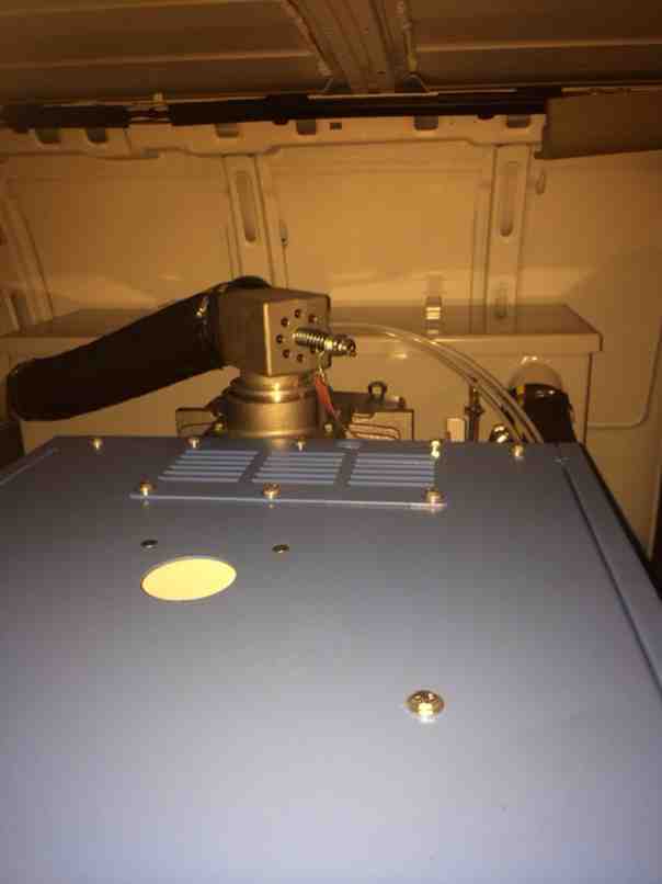

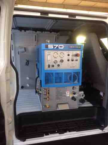

Still have a 2 level shelf to build and a few odd and ends to add but she's. 75% done.
Runs great. It's funny how the butlers I could literally run them with my eyes closed. I'm looking forward to getting to know her better and getting to that point.
This is going to make me do something I haven't done steady in over a year. Clean carpet lol
I will go out with this truck for a few weeks then wean off once I know the guys are 150% solid with it. Plus I want to know it too

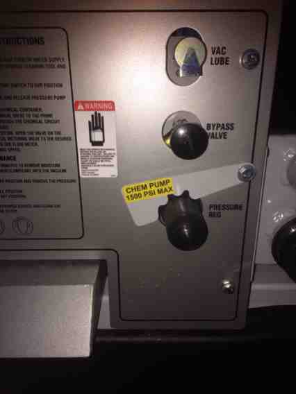

I had the remove and plug up anything having to do with chem pump

That is exactly right and once you level off and keep the incoming pressure at a constant PSI....your meter will level off with it............
I know Home Depot and even Walmart carry some in there RV section...But I wanted one with a gauge on it so the RV place here in town was where I got that one....

I run RO/DI water. We are completely self contained and bring our water to the jobs with us and take the dirty.
So I needed 200 gallon fresh and recovery
