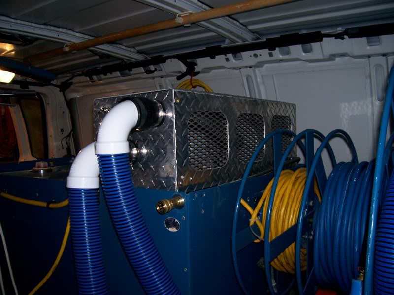

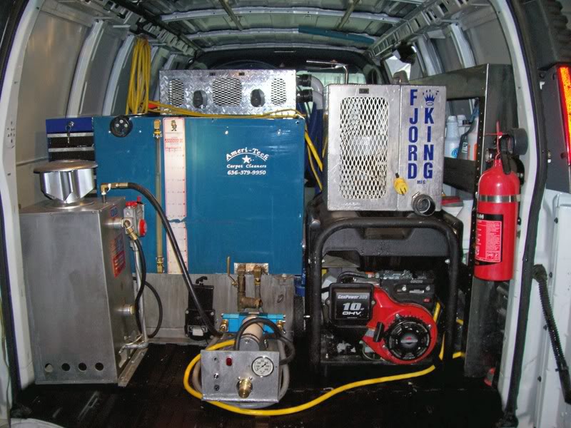

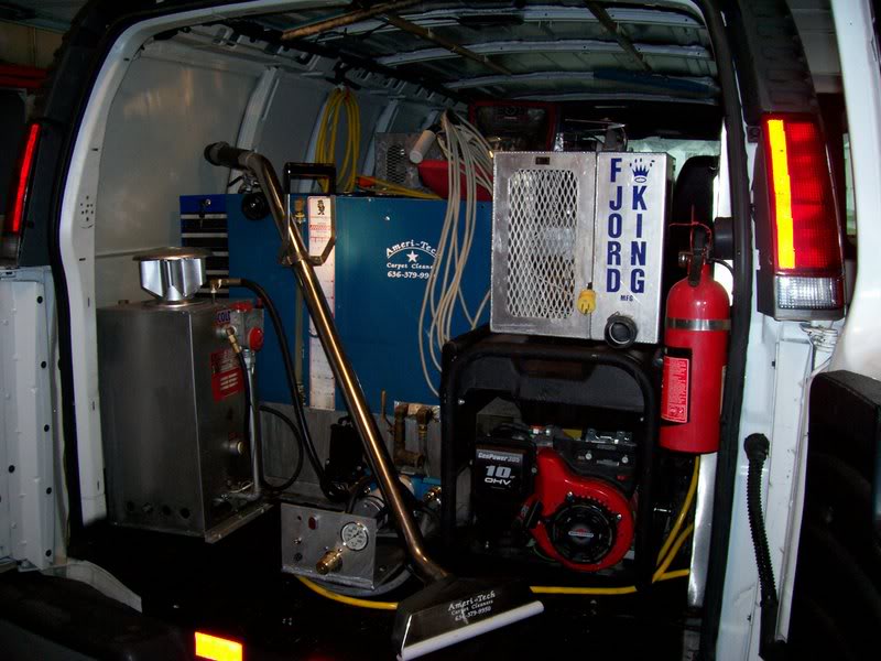

Vacuum blower & booster provided by Nordic 1 truckmounts, 500psi waterpump by pumptec, and 2ht little giant heater. Wand is a 14 inch westpak with a hybrid glide with 08 flow.

Doesn't seem like it should even be called a Bane. What's actually still stock on it?

Vacuum,cimex was out of the truck for the pics, I use a host machine for agitation and its behind the generator, no rotary.
Its does clean much better and faster, its a completely different machine.

Nice propane heater, were did ya get it? How many three stage vacs or what size blower on that bad boy. Interesting, very interesting......... 8)

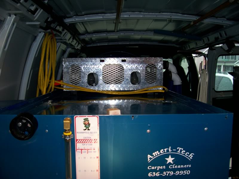

2 vac motors in the box on top of the tank, don't know the size. Got the heater from our friend Adam in TX.
Only thing left of bane is the tanks & reels, some chemicals.

dude did you or do you use the vac booster also and how many cords with the booster also plugged in.

3 plugs are run to the generator and when I use the booster, I plug in at the customer's home.

a little birdie told me those are some BIG vac motors in that diamond plate, I'll bet she sucks good without the booster, and now that you are cooking with gas, and 500 psi, it just gets better and better and better.
I see you have a blueline ergo handle on that wand, from the pic the head looks like a CMP, but I could be wrong, one single jet manifold, or two?

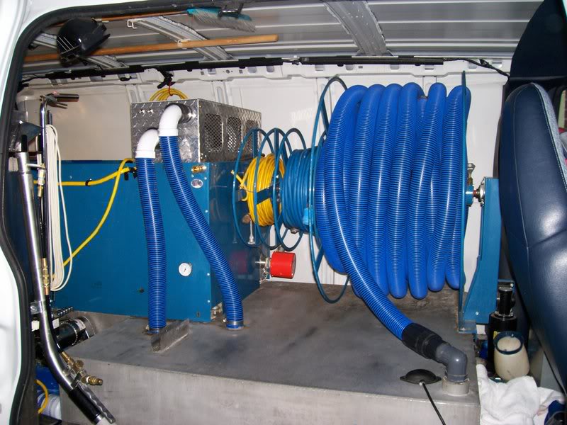

Is that 2.5 hose on the reel?
What is that orange thing beneath the hose reels?
What are you tank capacity's?

To answer the questions above.
No dist close to me had big tanks
I already had electric reels
The tanks & reels are only 4 yrs old.
Money was a huge factor, why spend 15k + when I had a good base to build.
Cheap to run and extremely simple to maintain
Replacement parts can be found a few miles from my house.
The footprint doesn't bother me, I have plenty of storage. I removed a great deal of equipment & chems to better show the modifications.
It was fun and frustrating at times, but well worth the effort.
