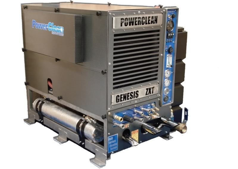

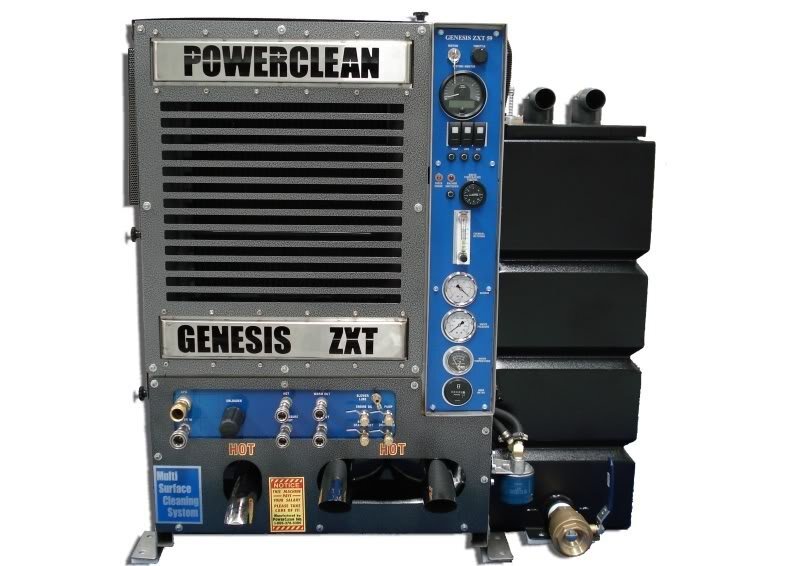

This is the new 68 horsepower PowerClean Genesis.

Here I thought the ding in the muffler was from shipping. Perhaps it's a TM of PCI :lol:
Then again, a quick look at the properties reveals all :lol:
From the Aussie board...
JIM, why didn't you panelbeat that muffler ding before the photos?
When's the diesel coming?
When are they going to put a half decent tank to match the performance of the unit? Also, look at those pidly little 2" ports there.... 'bout time they went to 2.5" isn't it?
John
Awesome machine. I have the Nissan one about 2.5 years old and love it.
I do think though that if anything lets the machine as a whole down it's the tank. A tank redesign with better flow and larger ports and possibly a better filter system would allow that 59 to BREATHE freer.
Not that I'm using it to the max anyway but they are my thoughts.

366
I like it. While I do like the GM motor I'm happy they went with this one. 68hp is really going to run that 59 blower nice. I thought I saw in the ICS truckmount mag a few months back that PowerClean changed their wastetank design for better flow? I'll have to dig out that issue but I'm positive I read that. I'm assuming they went with larger intake ports for the blower? Maybe not... They still have the Spears ports on the lid. I can't say much because I used em too. Greenie's Y adapter fixes that though. I tried to find a better connector but just couldn't. They either all had to be welded in which makes the lid less 'modifiable' or they just looked hideous.. I was hoping the Green one would make full 2 inch pieces that would interchange with these if a guy wanted.
