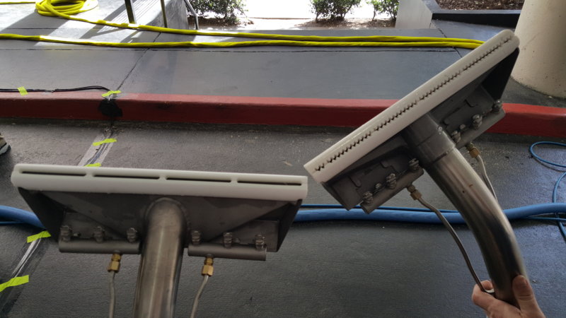

All the Ti wands these days are nice.
The best performing are those that were designed to NOT be used without a Glide.
A wide opening behind the glide is key.
The Dang Ti with the built in manifold is really cool. The redesigned swivel looks to be an improvement but way too soon to tell if it is stout enough. Jet placement looks to be perfect, which is good as there is no way to adjust the angle. The Mytee assist handle knock off needs polishing/ clean up, lots of rough plastic edges..
The Mytee was a screamer as well. Great internal flow design. The swivel was loose and jiggly, it almost felt broken inside the mechanism. The veiw window can't be seen from the user's perspective. Replacement won't be as easy as on the Dang, as it glued in. Mounting tabs for the manifold should be two to three times as thick as they are. If you are a wand scrubber type cleaner who uses the lips for agitation you'll love the metal glide. I'll assume Lisa will make a teflon option..
