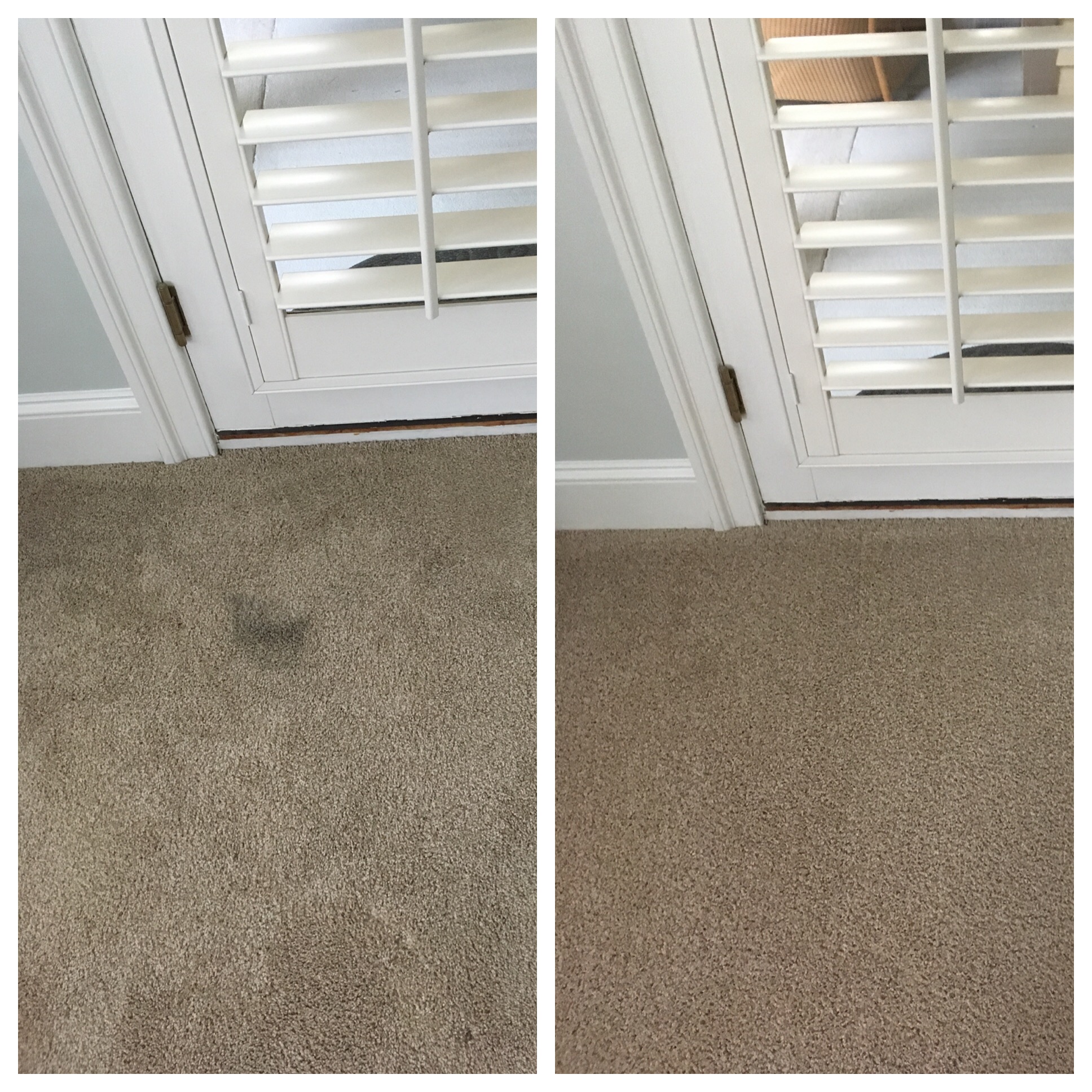

Jim Williams
1,465
Jim Williams
I used Prosolve gel on this one.
