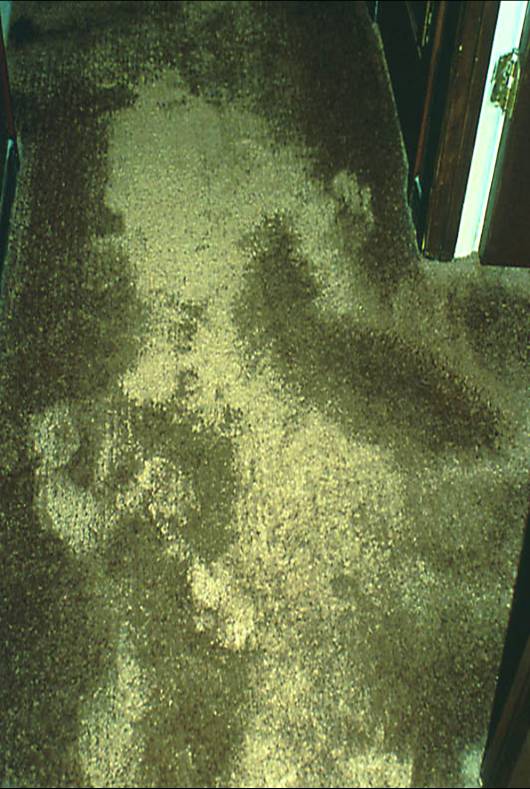

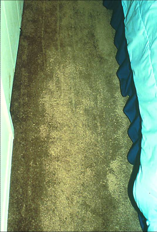

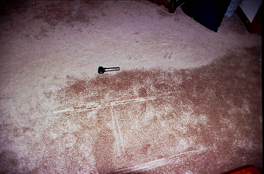

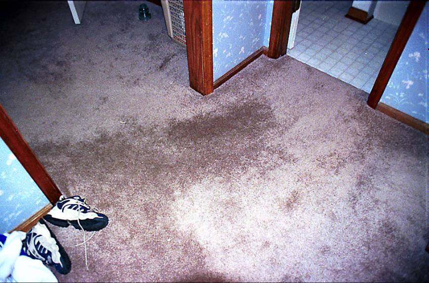

Chemically the fibers are different. Olefin and polyester both have a strong affinity for oil. An additional short-coming with polyester is its poor crimp retention. It will look flat and lifeless in the traffic areas pretty quickly, but they continue putting it out in cut-pile.
