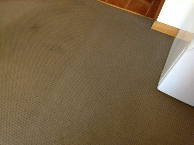

So today I had a somewhat grubby poly to clean. It went a bit like this.
Used 244 liters of water including pre-spray.
Recovered 215
Measure was 40 liter machine tank x fills + pre-spray.
Effluent out is measured as 20 liter bucket x full empty + fractions.
Rotovac 360i was used at 220PSI. I cannot adjust flow or pressure on my Porty.
I adjusted the flow control on the Rotovac to flow water very conservatively.
The site tube was a sea of foam and filth.
Flushing was good. Head speed was set t0 6. I did not adjust the speed of the machine at all during this cleaning.
I dried areas after extraction and then in some cases resumes flushing and then just drying up some more. I could have made it gush shit forever.
To finish u three the glided AW 29' on and dries some more.
Ticket was $120

Great work Grant! I've never understood why anyone would run the 360i at less then 10 for normal cleaning. I do like the option of turning the metal swoop heads down to 1 or 2 while at a delicate marble threshold, otherwise they chop a piece of marble out. Otherwise it's great guns a blazing.

Was that just one room and are you saying you left over 7 gallons of water in the carpet.
Yes just one room.
And went back over the carpet with a glided AW29 to recover the surplus.
Just trying to gauge Rotovac's recovery on a porty.
My use of the Rotovac I hope will improve too.
