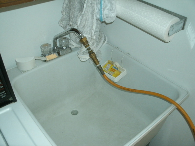

I don't find it that terrifying to hook a high pressure TM line to a well formulated fucet adaptor available at any hardware store. I do it on every porty setup. I look first for a utility sink otherwise I will find one usable source to hook to. I drape a towel over the hookup to avoid any disasters:
A utility sink is a great option to have, but I don't run into them too often. The fact that the sink threads are part of the faucet head are a nice benefit and usually give a solid connection. It's using a sink/hose adapter that I have grown frustrated with because I have found the connection between the standard sink threads and the hose adapter will be the weakest link usually leaking or blowing off all together. Many times I have returned to find hot water spraying across a bathroom or spraying and dripping down the hose to the floor. A towel is effective with a little leak, but only a bandaid. After too many near disasters, I found myself paranoid and uneasy whenever I hooked up my autofill inside someones home, and found much relief and peace of mind with a well planned bucket brigade. Most of the time I am a one man band, so having to check a sink connection every few minutes due to my own paranoia is not worth it. I prefer shorter shorter vac/sol runs and a more mobile porty setup.
