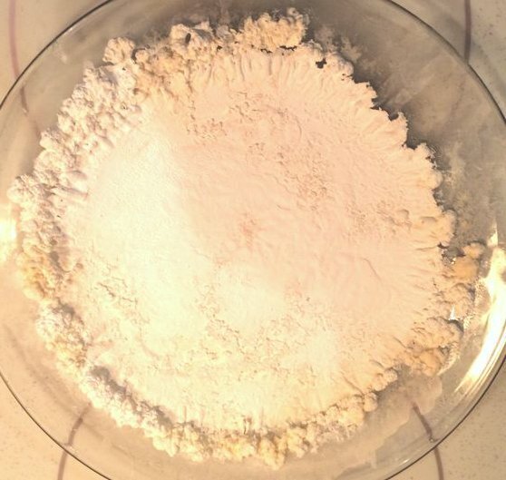

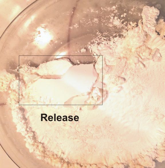

Been doing some testing this week on a "Powder Encap" product. It is similar to this product that Ashley M. tested in this Facebook thread: [www.facebook.com/groups/TheCarpetCleanersPage/permalink/611118355710379/?hc_location=ufi]
Right photo is 8oz of 50% "Powder Encap" dried on glass plate.
Left photo is clean release of product from glass plate.
What are your thoughts about a "Powder Encap" cleaner.

Starting from an absorbent powder base gives the product more capability to absorb soil to be vacuumed away,
compared to a liquid Encap formulation.
Larry Cobb
5,795
Larry Cobb
4oz. of Encap Powder + 4 oz. of water to make 8 oz of solution.
It is very soluble.
8 oz. were used to compare to the Encap testing done earlier in CleanFax magazine.

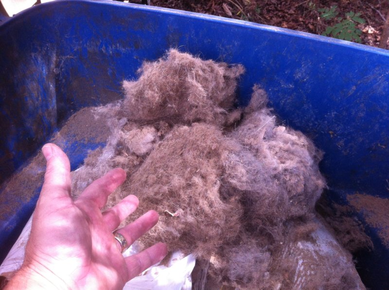

I was looking forward to the VLM webinar because I have alway thought of encapsulation as another word for shampooing. The difference is instead if a sticky residue it leaves a dry one. If you weigh the carpet before and after a powder encap like HOST, the carpet actually weighs more after it's cleaned because nothing was actually removed...in fact a cleaning product was added. For appearance cleaning I know there is a place for it but adding powder is adding...that is going in the wrong direction...IMO.
Before encap and after encap vacuuming, using Releasit DS2. I was astonished how much more stuff came up and figured out that the encapsulating made the hair, fibers and soils more slippery.
The dark grey bagful is the 'before' and the light grey lump the 'after'.
Both came out of a 10-quart backpack. The lumps are about the size of a gallon jug.
Right. Hit the send button before the punchline. Larry, if your product could enable that same sort of thing, I can see the advantage of a dry powder over lugging liquids. Especially when the elves decide to enjoy 'Butterfinger Monday'.
