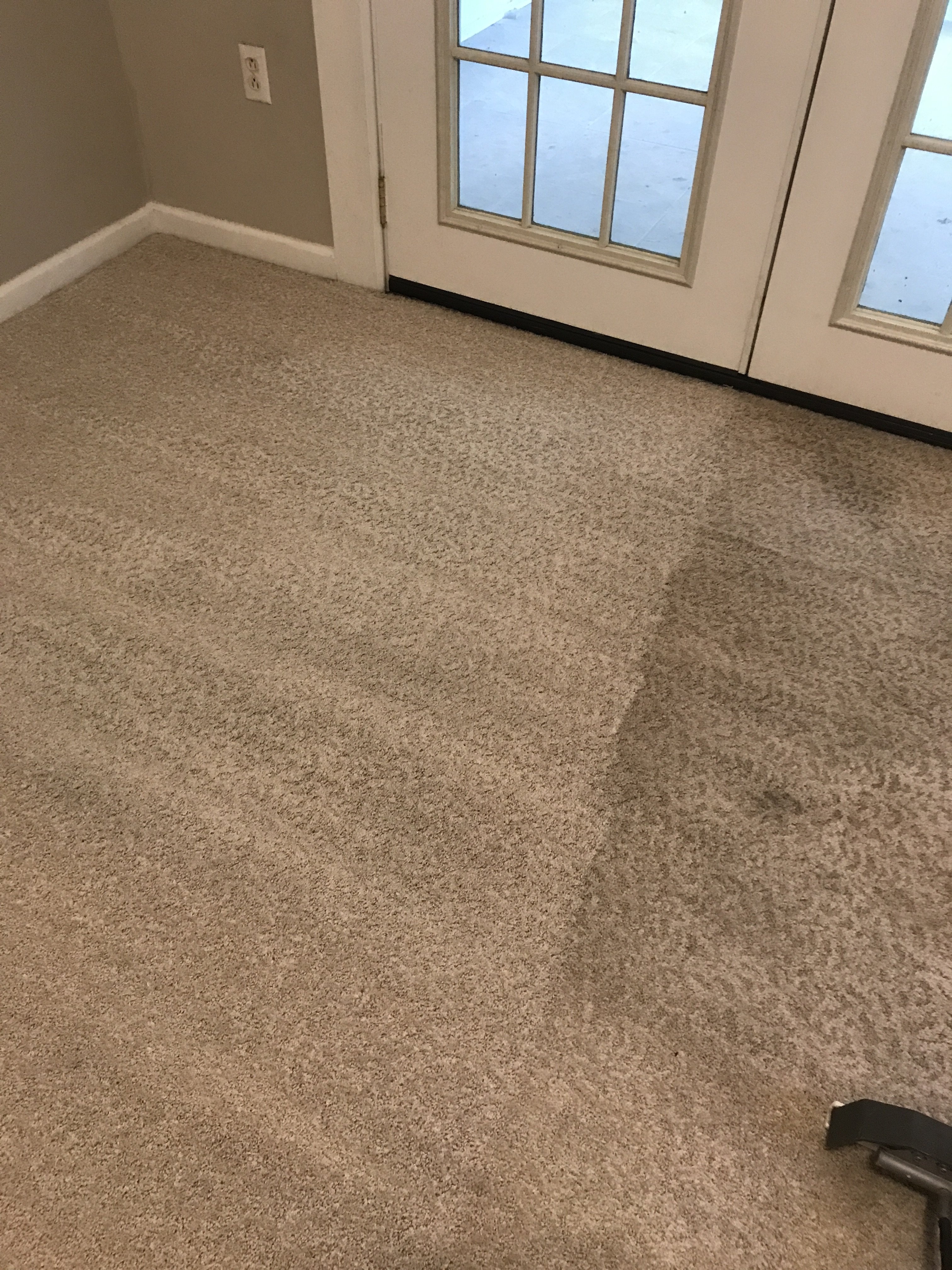

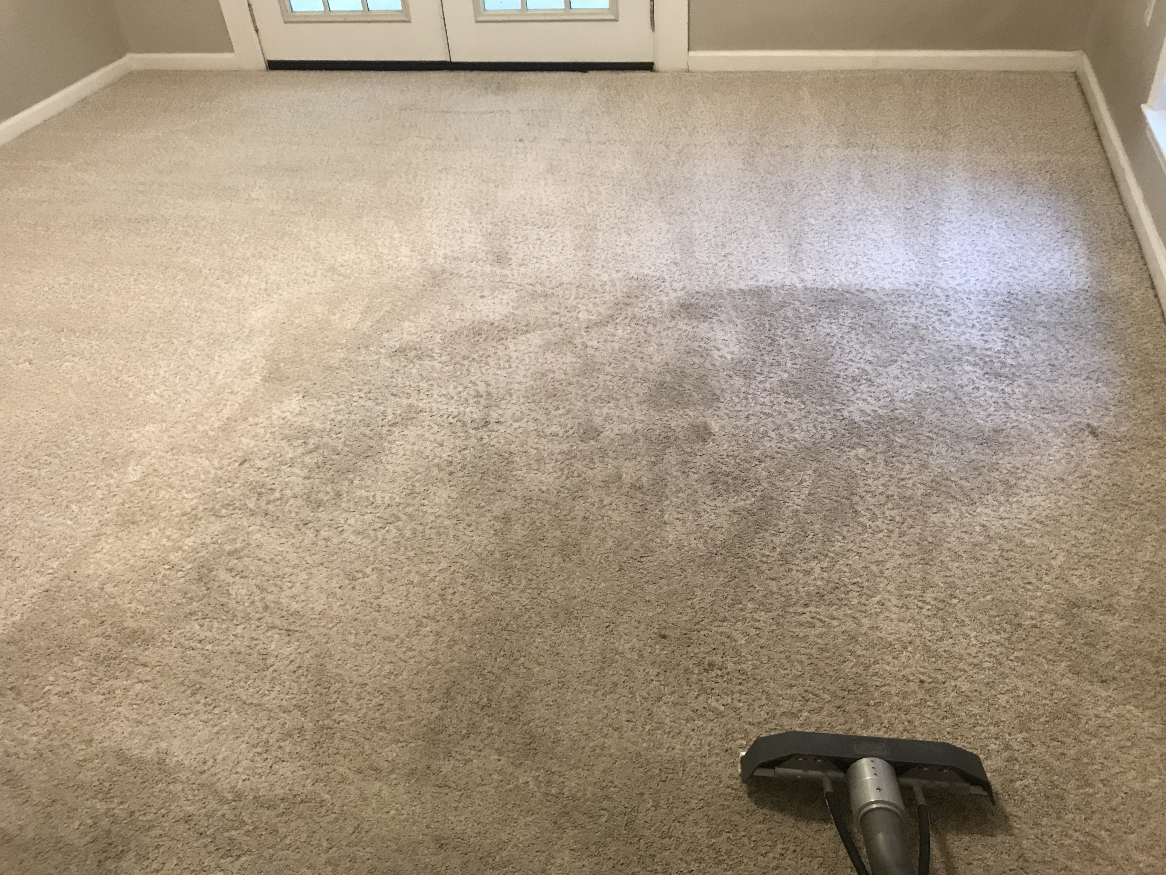

Last job was a three roomer today with heavy pet traffic that I somehow missed during the booking process. My P lime zyme was exhausted on the prior job. So I improvised and put 6 ounces of U-turn in a 4-1 hydroforce force. CRB then extract. Fingers crossed for no callback. 08F14DBE-991E-4AA4-B50F-0ADB3AAC5914.jpegA1AB067D-E8A0-42AD-98AA-A15CEF0EB561.jpeg091CC022-E605-468E-A487-30E7A8A14D52.jpeg
