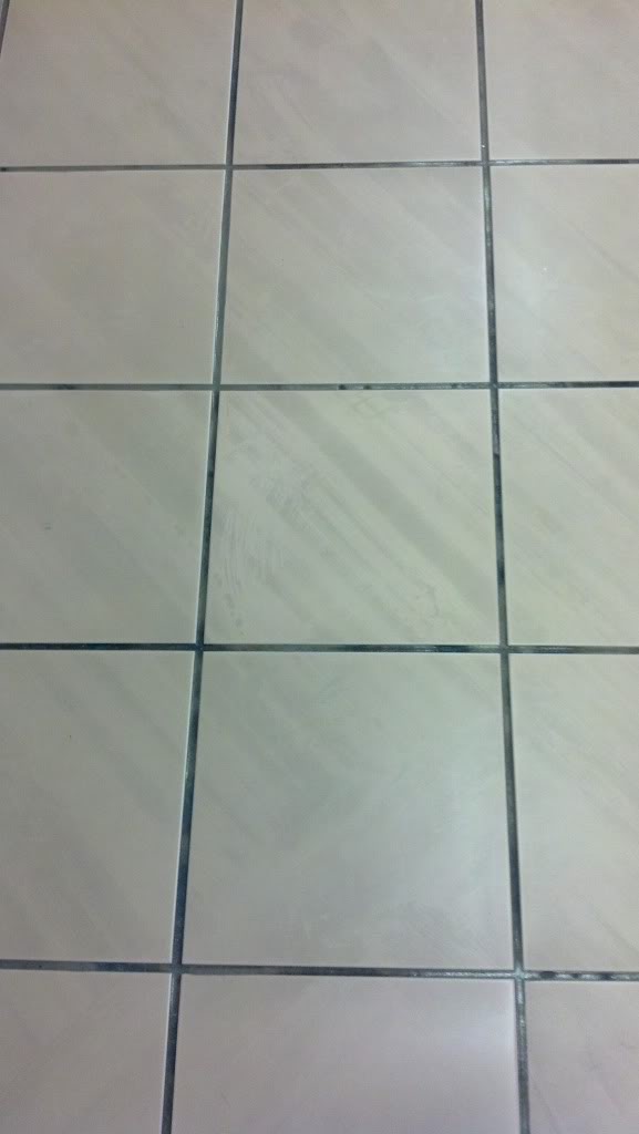

so this tile is about 12 years old. When installed it was acid washed, with what I don't know. Look at these pictures and tell me what you would do.
floor had wax on it for 12 years covering up those lines. they want move. Any ideas.

I see a footprint. Use polishing creme cleanser. Magic erasers, maybe even stone scrub. Soil is below surface in little micro pores. Much like unglazed porcelain
